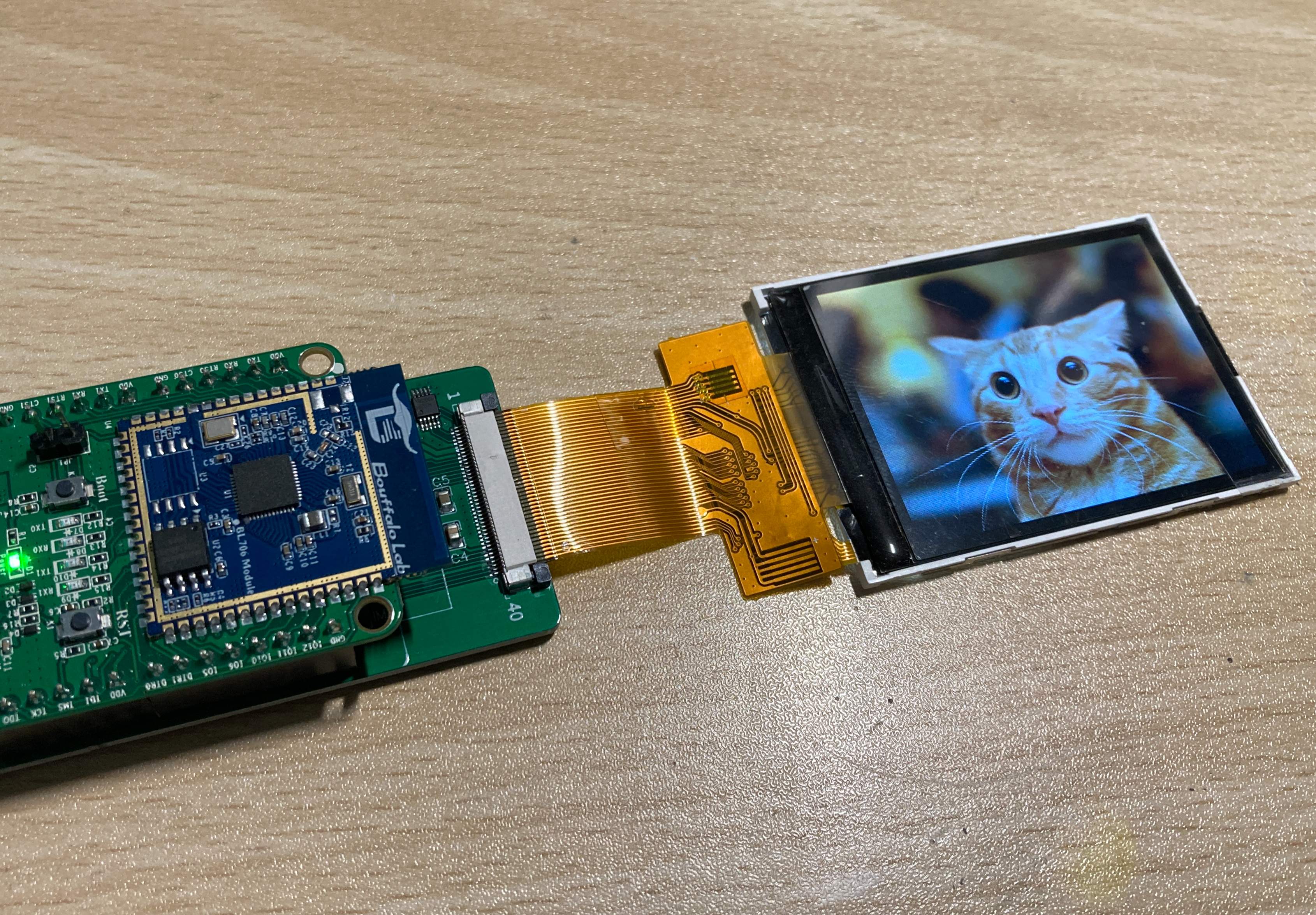

Welded finished product
Can be plugged directly into the BL706 core board
Connect to ILI9341/2.4-inch TFT-LCD
