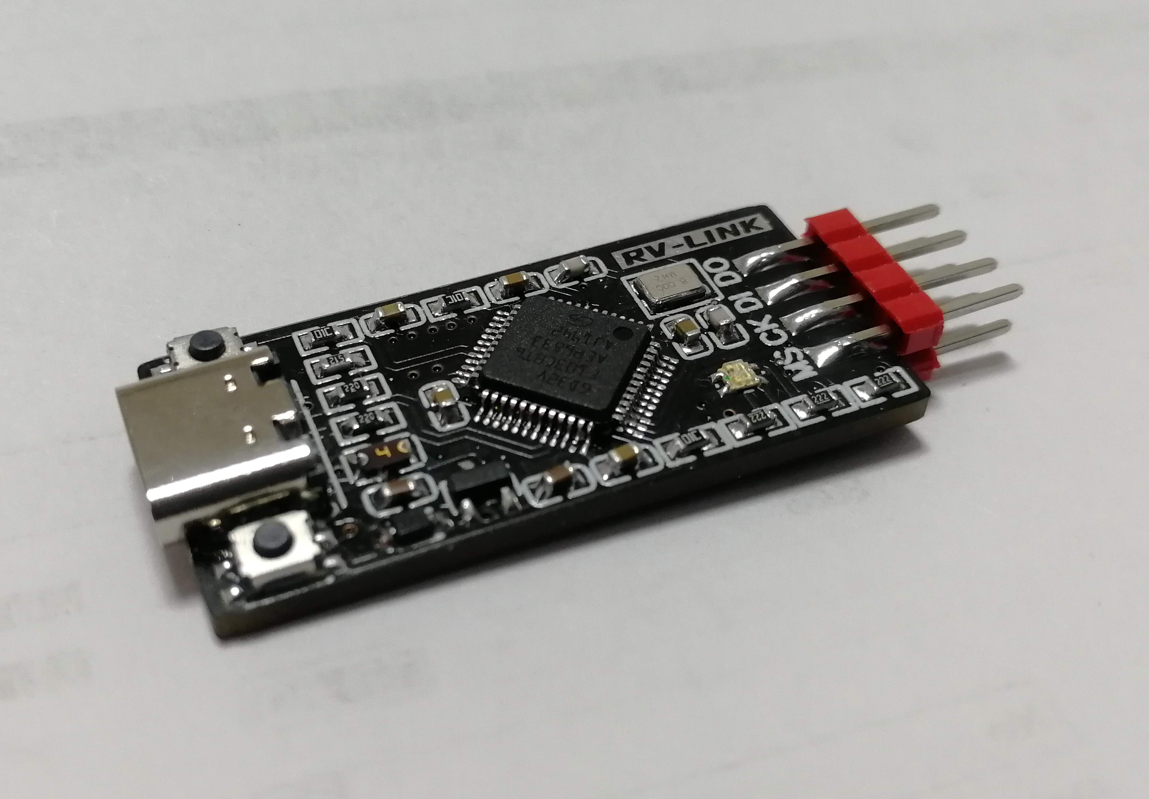

RV-LINK--emulator, the GD32VF chip becomes an emulator after burning the RV-LINK firmware, and can be connected to the external chip through the JTAG pin
Official related address: https://gitee.com/zoomdy/RV-LINK
Next, we will introduce the emulator, its circuit and firmware download steps. All relevant information will be placed in the attachment.
brief introduction:
  • The goal of RV-LINK is to make a RISC-V emulator, but the RV-LINK project does not include hardware. RV-LINK writes firmware for existing RISC-V development boards. Development boards with RV-LINK firmware burned can be used as Emulator usage
What is different from other emulators is that RV-LINK interacts directly with GDB through the USB serial port and does not require an intermediary such as OpenOCD.
  • Among the hardware officially provided by RV-LINK, the smallest one is Longan Nano, which is the smallest system board with GD32VF103 chip, as shown in the figure below:
        It is used to learn the GD32VF series with RISC-V as the core. It can also be used as an emulator after burning RV-LINK firmware. Of course, the chips it can debug are limited to the GD32VF series.
        As a minimal system, Longan Nano is small and exquisite, including LCD, SD card, etc., and is fully equipped. However, if used as an emulator, it is slightly complex, contains relatively many components, and is large in size. Looking at its schematic diagram, it not only contains the components required for the minimum system, but also includes the FPC socket, SD card slot, and an extra LDO circuit to power the LCD. These are relatively a waste of resources. .
        In terms of price, you can buy it on Taobao for about 25 yuan. If you make one yourself, thanks to Jialichuang’s 5 yuan advantage in making boards, about 10 yuan is enough.
  • In terms of application, the purpose of making it is to apply it to a small GD32VF development board I made, which will be open sourced later. The Longan Nano is larger than the desired range, so I made one myself.
  • Of course, in actual production, only the power supply, minimum system circuit, buttons, indicator lights, pin headers, etc. need to be retained. The schematic diagram can directly use part of the Longan Nano schematic diagram with slight changes. Let’s briefly talk about the circuit content. :
  • The interface still uses type-c. It inputs 5V and reduces the voltage to power the board. At the same time, it is connected to the USB pin of the chip to transmit signals. Since no external clock is needed, the 8MHz crystal oscillator can be retained. It contains two buttons: BOOT0 & NRST. Control the chip operating mode, use the status indicator light for status indication, and lead out the required pins. The Longan Nano schematic will be placed in the attachment.
