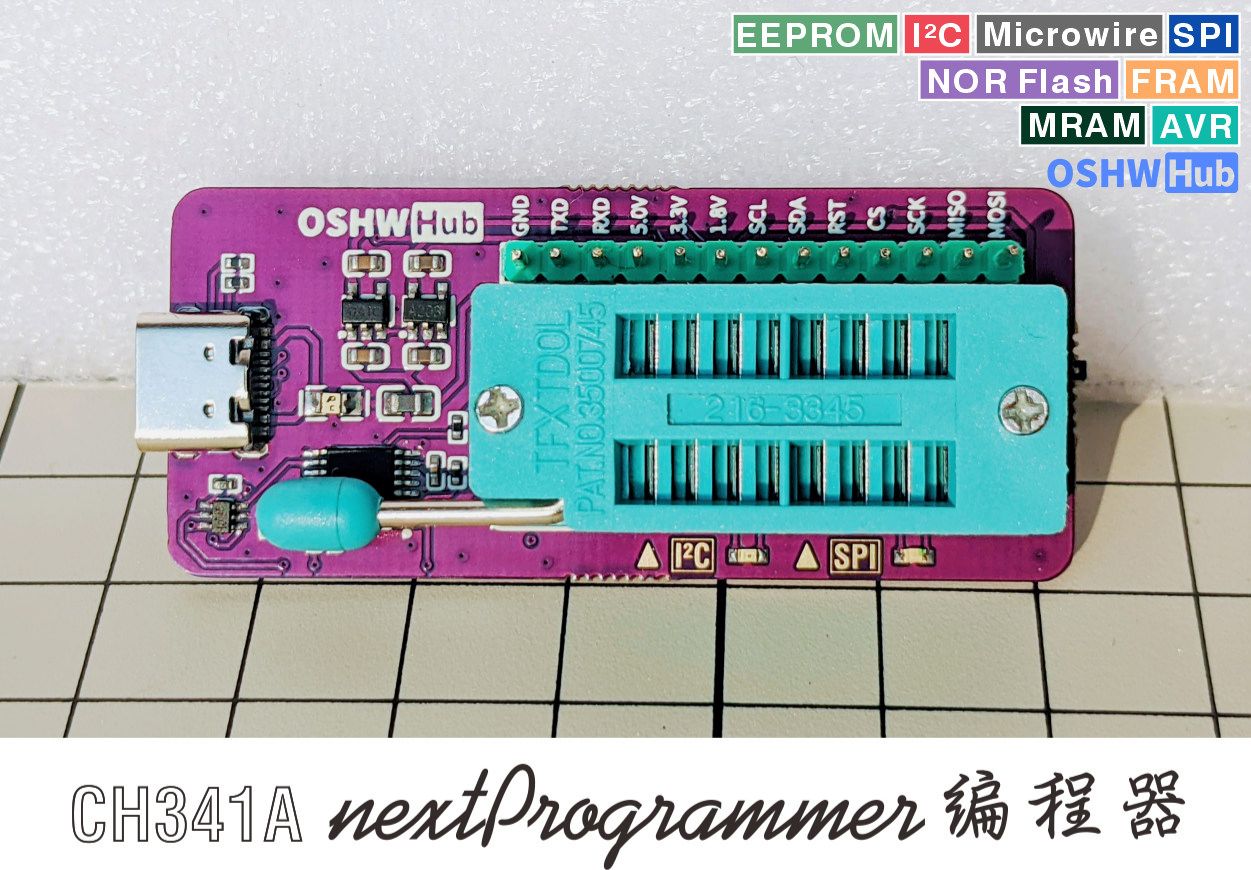

CH341A nextProgrammer programmer functions and usage
        The CH341A nextProgrammer limited edition uses a purple immersion gold 2-layer PCB. The front provides an USB-Cinterface for connecting to the PC host computer, a set of 2.54 (100mil) pitch pin headers and a ZIF16 chip holder for connecting to the target device.
        The PCB arrows near the ZIF16 chip holder point to pin 1 of the corresponding chip holder for I²Cdevices that use the protocol (such as 24 series EEPROM) and SPIdevices that use the protocol (such as 25 series NOR FLASH). When placing the chip or DIP8 adapter board, only Just align pin 1 with the arrow, which greatly reduces the possibility of incorrect chip placement (the 93 series requires an adapter board). The 13Pin pin header provides 3 sets of 1.8/3.3/5.0V voltage output (each set of 300ma can be powered at the same time), SPIand I²C3 UARTsets of interfaces, LVTTL level. Supports the transfer of Dupont lines, test pins or ISP interfaces.
        An independent I²Cand SPIcommunication indicator light is provided, which will flash when reading and writing the corresponding interface, making it easy to observe the working status of the programmer.
         The two sets of switches on the back of CH341A nextProgrammer are used to switch the target device voltage and programmer mode respectively.
