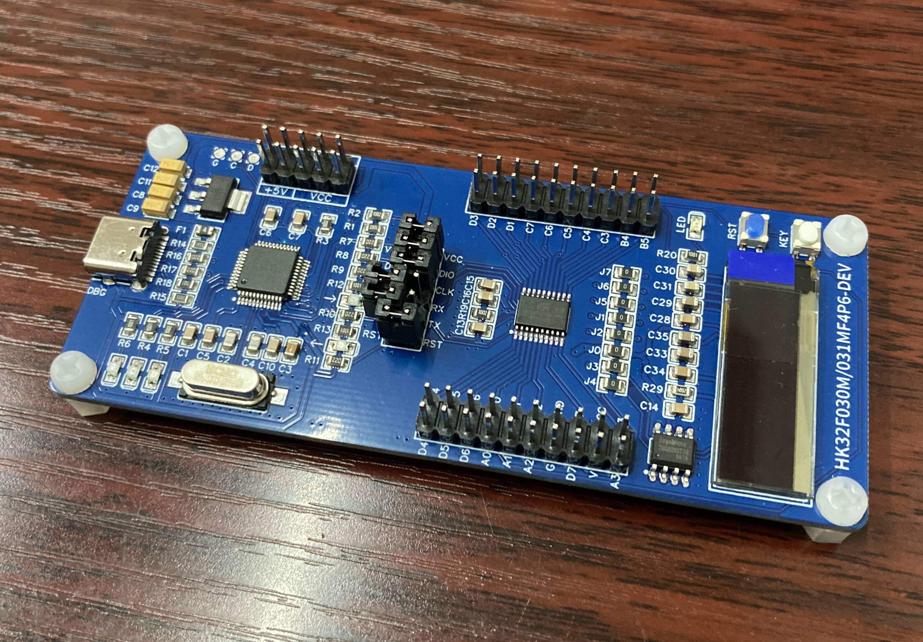

This is a development board/evaluation board based on Hangshun HK32F030MF4P6. It can be used to develop and evaluate applications based on HK32F030MF4P6. The development board has DAPLink (based on the hardware circuit and firmware of Jixin Technology [DAPlink emulator](https://oshwhub.com/jixin002/daplink_jx)) on board, supporting SWD debugging and serial communication. The board leads out all the IO of the MCU, and also has an SPI-Flash, an OLED display, two buttons (one of which can be configured as RST) and a user LED light on board. All these peripherals can be configured to connect to the MCU through jumper resistors.
# All functions
* Based on Hangshun's highly cost-effective HK32F030MF4P6, it has a 32MHz main frequency, 2KB RAM, 16KB Flash, 448bits EEPROM and an ultra-low price. Package is TSSOP20
* Compatible with HK32F031MF4P6
* 0.96-inch 128x32 resolution OLED monochrome display, connected to the MCU using SPI
* Onboard SPI Flash memory
* Onboard reset and user buttons, of which the reset button can be reused.
* One user LED, lit at high level
* Onboard DAP-Link debugger, providing SWD debug interface and serial communication function (based on Jixin Technology [DAPlink emulator](https://oshwhub.com/jixin002/daplink_jx)).
* Interface and power supply
+ Bring out all MCU IO
+ All onboard peripherals can be disconnected from the MCU through jumper resistors
+ Use USB-TYPEC interface for power supply and DAPlink communication
+ Dedicated power supply pins can provide 5V and 3.3V power to external modules (available when powered by USB), and this pin can also be used as a power supply for the development board.
+ The power supply of the MCU is independent of the main power supply and connected through jumpers, which is convenient for testing the power consumption of the MCU or using other power supply methods to power the MCU
+ The connection between DAP-Link and MCU is connected using jumpers, and some or all of the pins can be disconnected or connected as needed. After disconnection, the onboard DAP can be used as a general debugger.

# Picture
## Operation diagram
![image.png]
