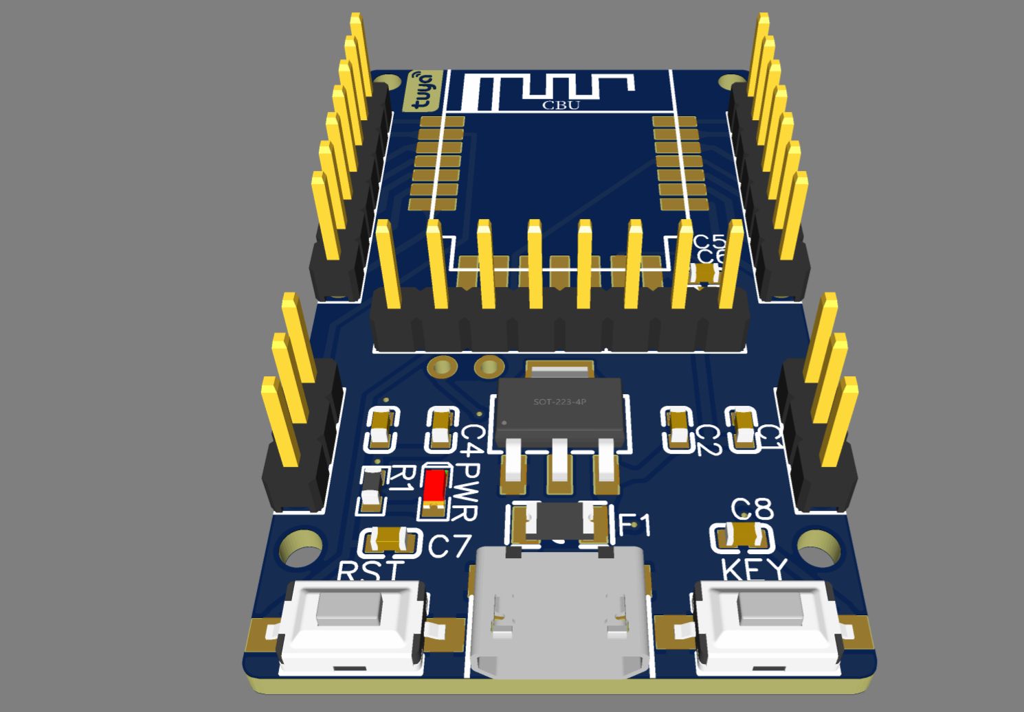

Tuya CBU Wi-Fi & Bluetooth module adapter board can be directly used in SOC development-free colorful lights (WS2812B), or can be connected to MCU (Arduino development board, ESP8266, etc.) using universal module firmware to achieve richer functions!
The KEY button can be connected to P6 through a short circuit on the pad, or it can be connected to the desired IO port through a flying wire on the pad to achieve control. When the F1 self-restoring fuse is not connected, please short-circuit the soldering pad directly.
The adapter board has a reserved MIC module interface, which can realize local music rhythm!
