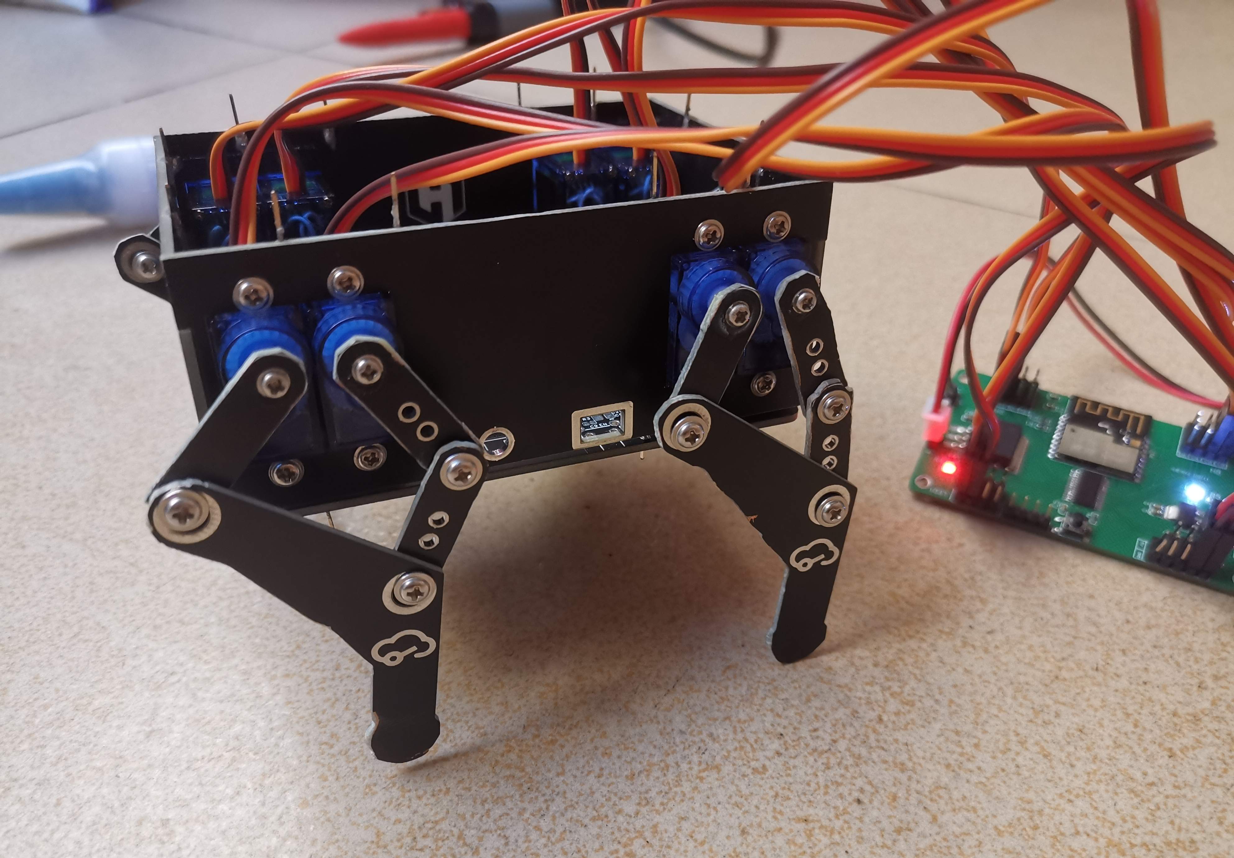

It is developed based on the OpenHarmony open source Hongmeng system. The chip used is hi3861, which supports 16-channel servo control ( PCA9685PW/Q900,118 ), GPIO, ADC, PWM and other operations.
Chip solution: multi-channel steering gear control board based on HiSilicon Hi3861 chip and PCA9685
Product core parameters:
Working voltage: 7.4V~20V with overheating and overcurrent protection
Double-layer board design single-sided layout
Total material cost of the complete set:
nameprice
power supplytwenty four
solder paste13.8
screw stud30
soldering wire4.5
Padtwenty two
8 servos48
Writer5
dog shell (pcb)20
Other originals are basically bought from Lichuang Mall, and an 80 yuan free coupon will be given during the event.
pcb: Jialichuang free prototyping
Dog body structure, reference
参考设计图片
