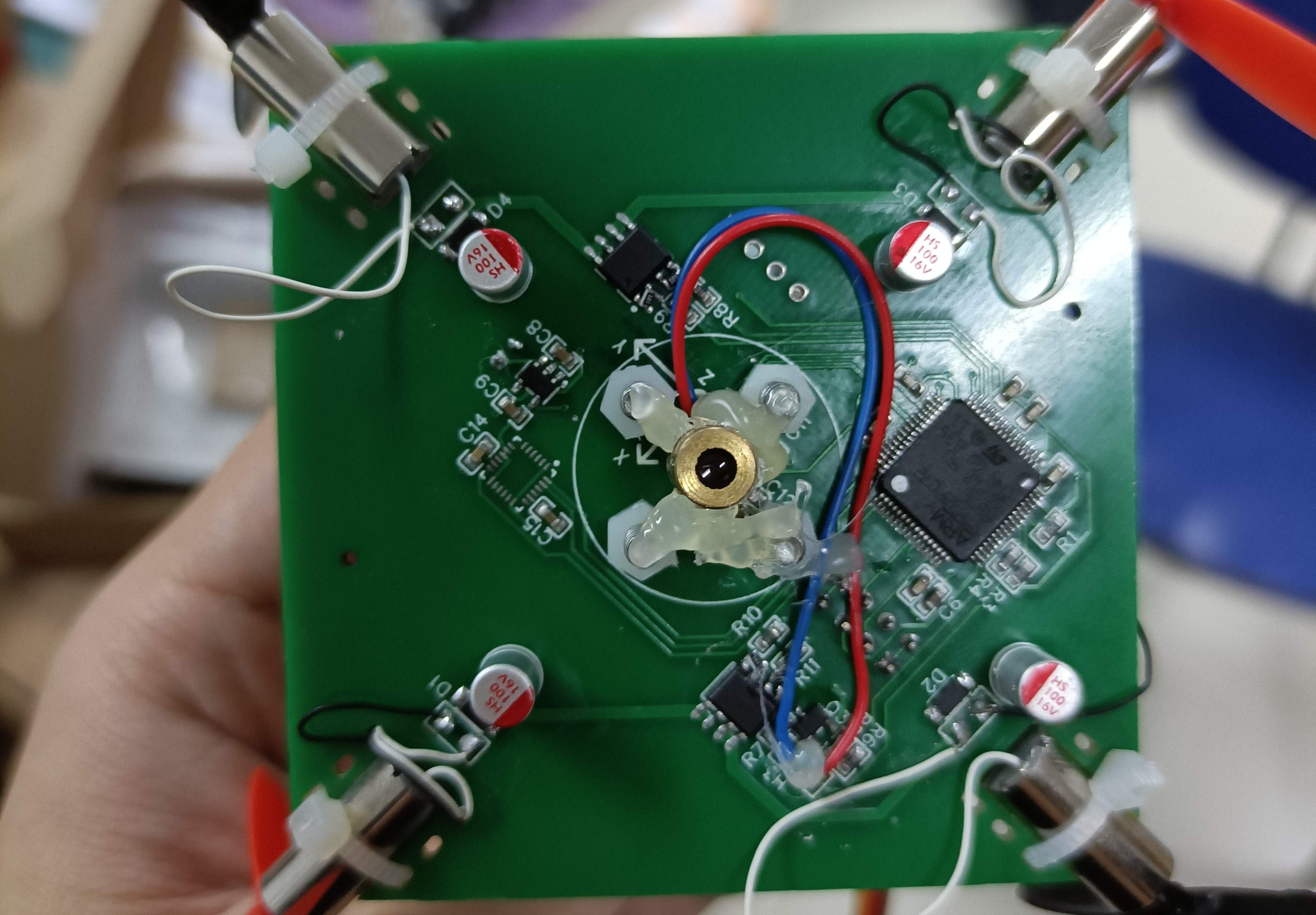

The wind pendulum control system uses STM32F072 as the main control, and the onboard ICM20602 attitude sensor can be optionally attached to 6050 for wind pendulum motion attitude detection.
At the same time, the wind pendulum uses a 716 motor as the motion execution system.
Output four hardware PWMs through STM32 and drive four coreless motors through MOS tubes.
The measured current of the coreless motor can reach 1.5A, and a high-power MOS is required.
Selection instructions
  1. STM32F072 is a low-power Cortex-M0 processor launched by ST, with a 48MHz main frequency and 16K SRAM. Sufficient for wind pendulum applications.
  2. This question does not have high performance requirements. I happened to be looking at the F0 series of processors at the time, so I thought about using F0 to give it a try.
  3. The IMU uses ICM-20602, which is also a commonly used IMU. MPU-6050 can also achieve it, and there is not much difference in performance between the two. Maybe 20602 has slightly better performance, but we just want to verify the chip used in ICM-20602.
  4. The overall structure uses PCB as the main structural component, and a carbon fiber tube (to increase rigidity) fixes the wind pendulum itself to the hanging wooden bars through flange couplings at both ends. The IMU is installed on the PCB and swings along with the entire system. The attitude of the system is determined through the acceleration and angular velocity output by the IMU, thereby achieving closed-loop feedback control of the system's state. Four coreless motors are installed symmetrically along the diagonal line of the PCB to obtain better mechanical symmetry.
