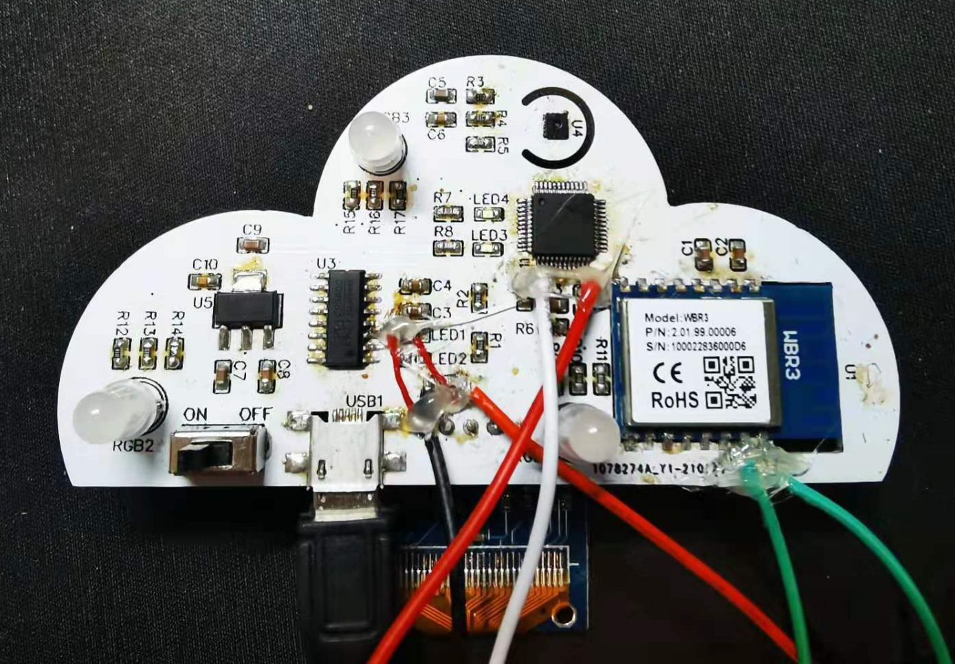

STC8A8K64S4A12 is used as the MCU master control. The temperature and humidity sensor SHT30 and the display OLED communicate with the MCU through IIC. The Tuya module WBR3 interacts with the MCU through the serial port.
The problem found so far is that the MCU and Tuya module cannot communicate through hardware serial port 4. It is guessed that there is no external pull-up resistor, so communication can only be done through external serial port 1 via a jumper.

The following is a basic function test diagram, that is, after the module is connected to the Internet, the status value is checked through the mobile phone (I use Tuya’s public board, and the app I implemented has not been transplanted and tested yet)
