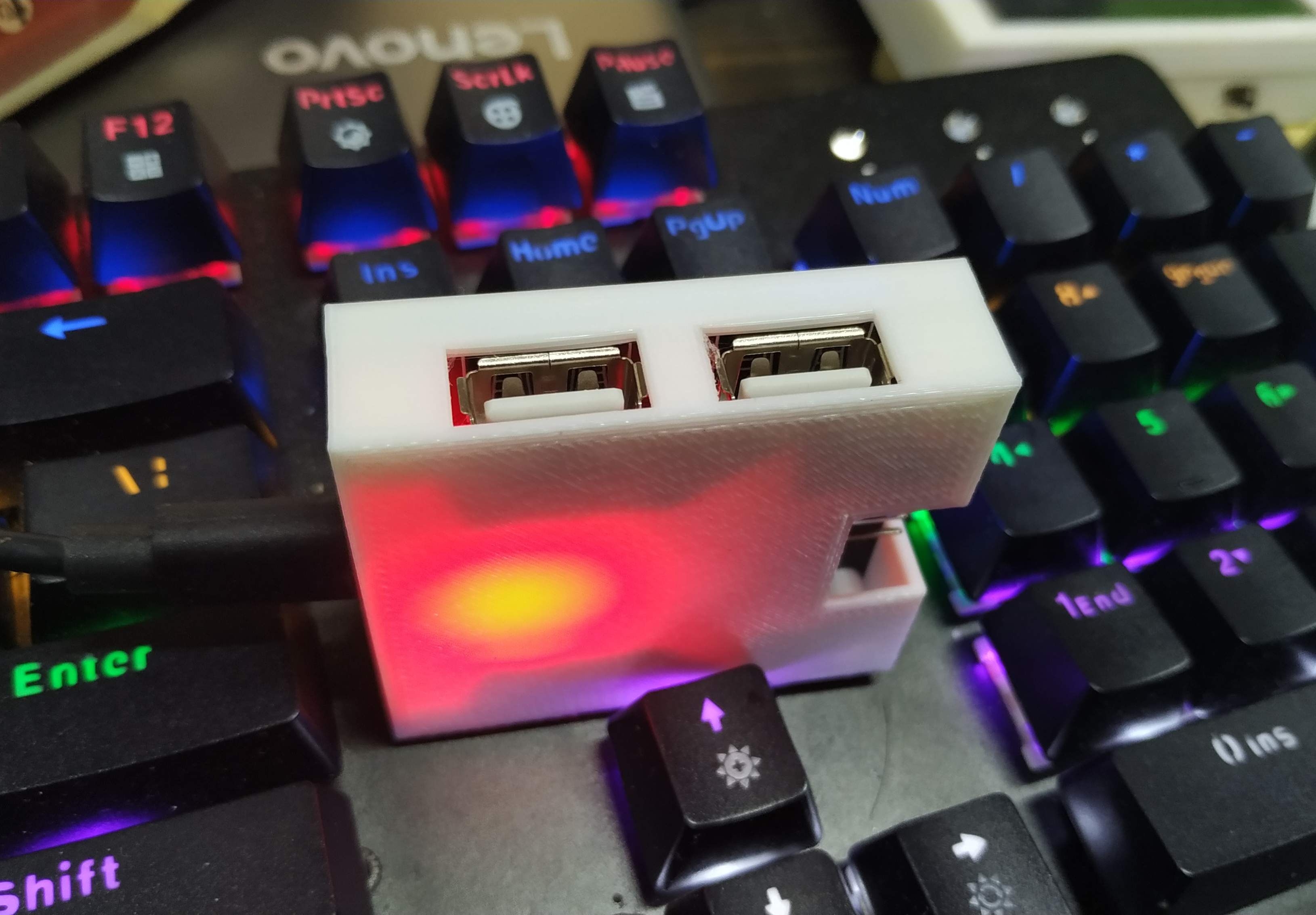

4. Physical pictures
image-20201121193758066
