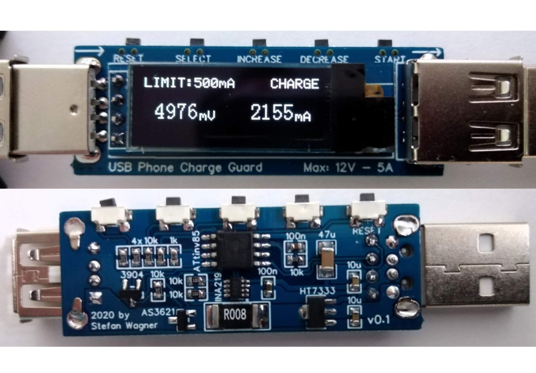

ATtiny45/85 USB Phone Charge Guard controls and monitors charging of phones and other devices. Voltage, current, power and energy are continuously measured via the INA219 and compared with user limit values. When user-selected conditions are reached, it cuts off power through the MOSFET. This controls the charge state of your phone's lithium-ion battery, extending its lifespan. User settings are stored in EEPROM.

The device comes with a USB-A plug for input and a USB-A socket for output so that it can be plugged in between a power source and your phone (or other consumer). D+ and D- are passed so that the phone can negotiate the charging protocol.
Voltage and current measurements
An INA219 is used to measure voltage and current. The INA219 is a current shunt and power monitor with an I²C compatible interface. The device monitors shunt voltage drop and bus supply voltage with programmable transition times and filtering. Programmable calibration values ​​combined with internal multipliers enable direct reading of current in amperes. The 8 milliohm shunt resistor was chosen to have very little effect on the circuit while allowing measurements to be made with 1 milliamp resolution. For accurate measurements, choose a shunt resistor with low tolerance (1% or better)
voltage stabilization
The device supplies 3.3V via the HT7333 LDO regulator, which draws input voltages up to 12V from the USB bus power.
MOSFET
The connection between the power supply and the phone is turned on and off via the AS3621 P-channel MOSFET. Despite its small size, it can continuously switch to 30V and 6A. Its internal on-resistance is only about 20 milliohms.
Operation interface
The user interface uses five buttons and a 128x64 pixel OLED display. An ATtiny45/85 microcontroller handles the user interface, the power connection of the measured values ​​and the control of the calculation and display.

  1. Connect the device between the power source and the phone (or other consumer).
  2. Use the SELECT/INCREASE/DECREASE buttons to set charging limits.
  3. Use the START button to start the charging process.
  4. Use the SELECT button to switch between displayed values ​​during charging.
  5. When the set limit is reached, the charging process stops automatically.
