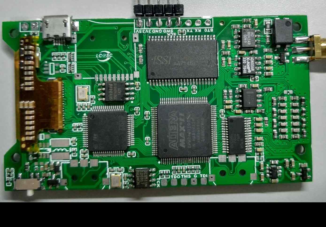

Brief introduction to the work: This project designed a very small, portable and low-cost arbitrary waveform generator with a volume of only 80x44x5mm, slightly smaller than a credit card. It can be easily carried in your pocket and supports lithium battery power supply and can be used immediately after taking it out. In terms of performance, the DAC waveform output sampling rate can reach 100MSPS, it can output sine waves below 25MHz and arbitrary waveforms below 5MHz, and the waveform amplitude and offset are adjustable. 1. Details of the work; This design uses the architecture of MCU+CPLD+SRAM+DAC to realize the high-speed DDS structure, uses MCU to perform waveform operations and generate waveform lookup tables, and uses CPLD with high-speed SRAM to achieve high-speed output of the lookup table. After receiving the data from the MCU, the CPLD writes the data to the SRAM in a FIFO manner, and then cyclically outputs the lookup table data to the DAC at a certain rate to achieve high-speed and arbitrary waveform output.
Technical parameters: Waveform sampling rate: 100MSPS Number of output channels: 1 Maximum frequency: 25MHz Basic waveforms: sine wave, square wave, triangle wave, sawtooth wave, SINC pulse extended waveform: customizable lookup table length: 512KB Analog front-end 3dB bandwidth: 25MHz Output waveform peak value: less than 5MHz: 40mVpp~5Vpp less than 25MHz: 40mVpp~2Vpp Output waveform offset range: -3.3V~+3.3V Output impedance: 50ohm Output shutdown leakage current: 1uA Output shutdown maximum peak withstand voltage: 300V Power supply: 5V-USB_Mirco input or built-in lithium battery

Hardware part 1. For the low-speed human-computer interaction part, it is mainly composed of MCU and peripheral screen buttons and other human-computer interaction components. The connection between the screen and the MCU and the connection between the CPLD and the MCU both use an 8-bit parallel port. Two three-way button ports support large dial buttons and rotary encoders. They are designed to be connected to the encoder interfaces of timer 2 and timer 3 respectively. One important point in this part is that because the IO of the microcontroller is not enough, AD buttons are used. This design can use one IO to read 10 buttons. The circuit diagram is as follows. The AD button is designed to press the voltage at each point to support more than 10 buttons. ADKEY.JPG The program reads the ADC every 1ms, and then performs debounce and button service. It can distinguish between short press and long press, but it does not support multiple keys at the same time. Press. 2. For the high-speed digital part, it mainly consists of three devices: CPLD chip-EPM240, high-speed SRAM chip-IS61LV25616AL, and clock generation chip-ICS511. The first is clock generation. Only the support of a high-precision, low-jitter high-speed clock can ensure the accuracy of waveform generation; the crystal oscillator used is a 25MHz crystal oscillator provided by Jiali Bandage, the manufacturer is YXC, and the accuracy is 10ppm. The PLL chip used is ICS511, which can provide 2-8 times programmable multiplier output, up to 200MHz. Its jitter performance is excellent, the absolute clock cycle jitter is +-70ps, and the single-cycle clock jitter is 20ps. In this paper The design provides a stable clock of 100MHz for digital high-speed systems. The second is the high-speed SRAM chip. As the cache of the lookup table, ISSI's IS61LV25616AL-10 is selected. This is a high-speed asynchronous static RAM. Compared with SDRAM, the operation is much simpler. No refresh operation is required, which saves CPLD. The internal logical resources are already compact. The access interface of this SRAM is 256Kx16 bits, and the interface access speed reaches 10ns, which means it can reach an access bandwidth of 200msps, which is enough to support the DAC data throughput requirements of this design. The lookup table length is 512K, which also meets the majority of waveform generation. application requirements. The CPLD chip is the core driver of DDS. It reads the lookup table data from the SRAM cycle by cycle from the obtained clock and outputs it to the DAC, providing a stable and accurate data update rate at equal intervals. The DAC chip is ADI's AD9708, which is an 8-bit 100Msps high-speed DAC. In order to facilitate compatibility between series, the chip package supports 14-bit data. In the circuit design, all 14-bit data channels are linked as a compatible design, which can be upgraded to higher precision in the future. DAC. 3. The high-performance analog front-end part can be said to be the soul of this project. Without a good analog front-end, it is impossible to output clean waveforms. The analog front-end in this design mainly has four functions: DAC output filtering, signal gain control, signal offset control and output drive and protection. According to the principle of DAC, the DAC output needs to be connected to a reconstruction filter to eliminate high-order harmonics. Wave. Because the DAC output is a current-type output, a ninth-order passive Butterworth filter is designed here to implement the reconstruction filter. Use professional filter design software to design the filter as shown below (because inductors and capacitors need to be purchased with a certain accuracy, so the curve is offset due to approximation). 9th btwz1.JPG The simulation results are Simulation results.JPG 3dB attenuation frequency point 3dB attenuation frequency point.jpg and stopband frequency point. Stop band frequency point.jpg The final circuit design uses differential Current structure LFP.JPG corresponds to physical design 9th btwz3.JPG
The signal gain control part uses ADI's AD603 chip, which is a voltage-controlled variable gain operational amplifier. In this design, its gain range of -11dB to +31dB is selected. At this time, the chip has a bandwidth of 90MHz, which is sufficient to meet the design needs. Using the DAC output of stm32 and converting it to +-1V can achieve digital controllability of the signal peak-to-peak value from 40mV to 5V. Signal offset control uses ADI's AD8042 high-speed operational amplifier. One of the AD8042 is a rail-to-rail high-speed dual operational amplifier with a 3dB bandwidth of 160MHz and a slew rate of 200V/us, which can meet the needs of high-speed signal output. The circuit that implements offset control and output drive and protection is as shown below. The OUT.JPG final drive output drive is in one direction, and you can choose whether to design amplification or not. AD8042 can increase the output current up to 50mA, which is enough to drive common loads. The output switch is controlled by AQY210 optocoupler and has dual diode overload protection. The voltage used for gain control and offset control comes from the built-in DAC of stm32. Its output is 0-3.3V, while gain control requires +-1V and offset control requires +-3.3V, so an operator is required. to complete the conversion. But there is a problem involved here. The system power supply is +-3.3V. There are very few operational amplifiers that require input and output rails with a voltage resistance of more than 7V. Indeed, 5.5V voltage-resistant operational amplifiers are made with cmos technology and can easily realize input and output. Rail to rail, but the CMOS process cannot withstand too high a voltage. High-voltage op amps are mostly triode processes. Most of them can only reach the ground rail, and very few can reach the power rail. After searching for a long time, I finally found ON Semiconductor's MC33202. This op amp can withstand voltage up to 12V, which solves the problem. The control voltage mapping circuit is as follows 33202.JPG
There are two options for the power supply part. You can choose the analog domain +-3.3V, which has lower power consumption and is suitable for battery use. The analog domain +-3.3V is composed of LDO + negative voltage charge pump. You can choose the analog domain +-5V, which can double the power consumption. Suitable for high-performance applications. It has a wide output voltage range. The analog domain +-5V is composed of BOOST DCDC. Different functions are realized through optional welding. The analog ground and digital ground are carefully designed for ground processing, and a single ground is designed closest to the DAC. Connect the analog and digital ground points and set up a complete ground plane for the key filter amplification loop and fully ground it. GND.JPG

4. Upload the picture of the work; the appearance of the PCB proofing returned. Thanks to the SMT proofing service provided by Lichuang, which saves a lot of welding work. 4.JPG The back of the blank board 5.JPG is welded, the front I3yctE8EESy7bbZrtGbq84J3MBR6YrWeY0rfo2SS.jpeg is welded, the back is welded 6.JPG , the screen is welded, and 2.JPG the size in the hand 7.JPG is compared with the Beijing Transportation Card ( credit card) size 3.JPG
