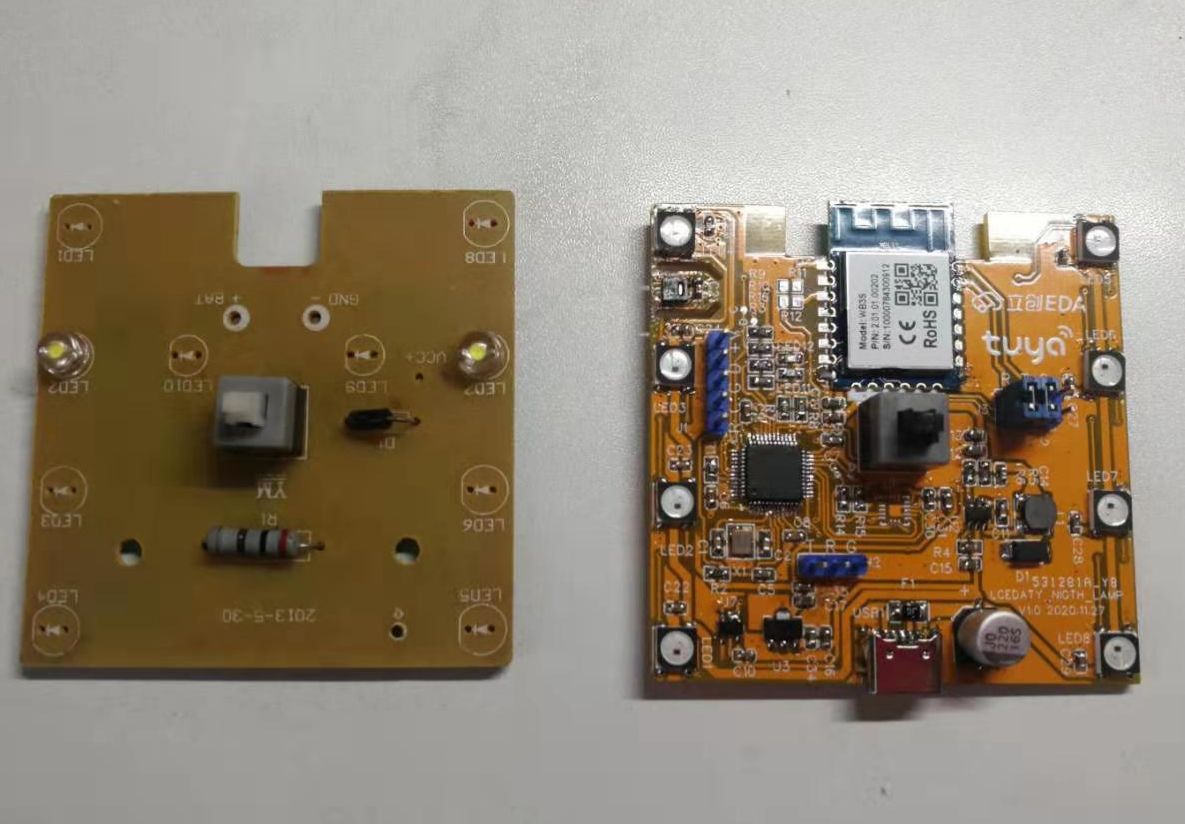

Power supply section
  1. The interface uses typye-c, a 500mA self-restoring fuse, 50mA when the light is off, and the total power consumption is more than 400mA when the light is on.
  2. Because the peak power consumption of wb3s is 100mA, use DC-DC, 5V-3.3V as the power supply.
  3.  The MCU and temperature and humidity sensors use another set of LDOs as power supplies.
power.pngWeChat screenshot_20201206161535.pngWeChat screenshot_20201206161523.png
MCU part
An STM32F103 microcontroller is used, with debugging LEDs and debugging serial ports reserved.
WIFI module
  1. Tuya's WB3S, MCU general firmware, note: the PCB is hollowed out at the antenna.
  2. J3 frame skipping can be disconnected. When using Tuya's serial port debugging assistant, you can simulate the module to debug the MCU, and you can also simulate the MCU to debug the module. Tuya's debugging assistant is really convenient to use.
  3. Tuya MCU SDK development process. https://www.tuya.com/cn/product/iot/MCU-Low-code-Development
Light source circuit
  1. Using WS2812 as a light source, colored light display can be achieved.
  2. The 74ahct AND gate of U7 is used for logic level conversion from 3.3V to 5V. The Vhin of WS2812 is 0.7Vcc=3.5V.
  3. I originally wanted to use a triode to implement it, but after some simulation, the speed was not enough to reach the 100ns speed of ws2812, so I simply used a 74hct series circuit.
QQ screenshot 20201206155211.pngWeChat screenshot_20201206155347.png3.3v-5v.jpg
Temperature and humidity sensor
  1. I2C protocol, pay attention to the pull-up resistor.
  2. Grooves are made when drawing the board to reduce temperature transfer to other devices.
Software debugging
  1. The framework uses st's mxcbue and free-rtos.
  2. Tuya's MCU_SDK porting is really convenient. I just watched the video and finished it in one, two, three, four, five, more than half an hour.
  3. [Link to Tuya IoT development platform] https://auth.tuya.com/?from=https://www.tuya.com/cn/&_source=cbc30f99f7a6c4aebca6755c2fab437f (contains detailed development documents)
  4. The ws2812 driver uses spi+dma mode.
  5. The code is hosted on github and will continue to be debugged at https://github.com/potatozerogo/lcedty_night_lamp.git
Design needs improvement
  1. Since the original night light lampshade is yellow and the color effect is not good, only white light is used.
  2. When the APP uses palette dimming, the MCU will get stuck. It should be a UART communication problem. I don't know whether it is Tuya's SDK or the hal library. I haven't located the problem yet.
  3. The hardware also reserves an acceleration sensor to identify different slap light effects. The function has not yet been implemented, and debugging will continue later.
