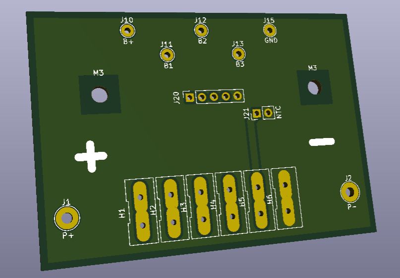

Dongcheng's 14.4V battery charger uses unbalanced charging and directly charges in series. When the voltage of a single battery reaches the critical point, charging will stop directly, which will cause the voltage difference between batteries to become larger and larger, so I made a board and used B6 charging.
This is what the terminal is used for
The balanced head socket in the middle is 2.54 pitch, and either a flat pin or a straight pin socket will work.
Note: Before use, you need to disassemble the battery box, remove all the resistors on the board in the battery box and short-circuit them.
1. I don’t know if I can still use the original charger after taking it off.
2. It can be used for direct series charging without removing the resistor.
