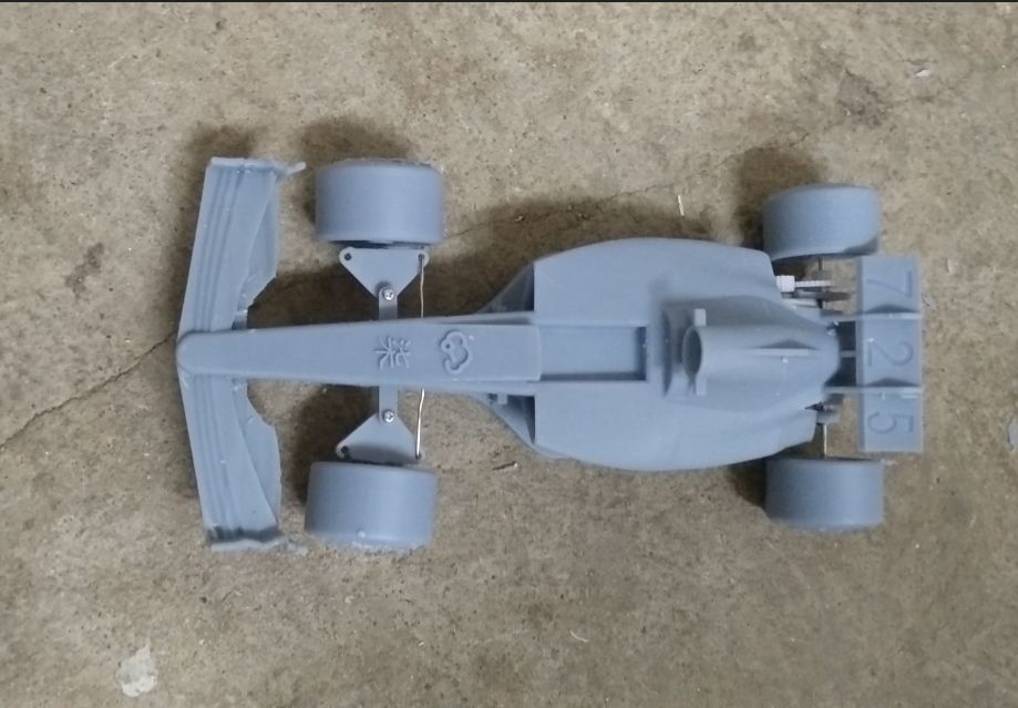

Project description
This project is a smart F1 formula racing car based on esp32, lgt8f328p, stc104w three MCUs. The model part is led by disciple 725, and the electronic part is drawn by Ace Pigeon 725.
Streamlined appearance design perfectly combines function and appearance
circuit
ESP32
This project uses the ESP32-WROOM-UE module, which is mainly small in size and can be connected to an external antenna. The main function is to communicate with the remote control and drive the ov2640 camera to achieve wireless FPV.
LGT8F328P
The main reason for using LGT is that it is cheap. The main function is to receive the signal sent by ESP32 through the serial port, decode it and output the pwm signal to control the ESC and servo. It is also the main control of the tracking module, realizing tracking and obstacle avoidance functions.
Luoli ESC
The Luoli ESC is a god-level work of the guy "I love Luoli loves Luoli". It is famous for its cheap manufacturing cost and low cost (don't hit me if I'm wrong). Acts as a motor driver in this piece (duh).
Tracking/obstacle avoidance module
Tracking and obstacle avoidance are both implemented by infrared. There are 5 channels of infrared tracking and two channels of infrared obstacle avoidance on the left and right. It also has 2 channels of white light. All parts are made of patches to reduce the PCB area and volume and make it easier to install. At the front of the car.
Function
I won’t say much more about this, it’s been mentioned above
Mobile phone/computer web remote control
The implementation method is to create a webserver on esp32 and run the webpage to control it on the webpage with real-time video preview (ov2640 lens mentioned above)
TFT touch screen control
The screen uses Qiming's 3.5-inch tft touch screen development board, which comes with esp32. You can easily use the esp now protocol to communicate with the motherboard esp32 to control the remote control car.
Item/face tracking
The implementation method is that esp32 creates a real-time stream to push the things captured by ov2640 in real time. The computer uses python and opencv to pull the stream from esp32. After analysis and calculation, the motor speed and servo angle will be passed to esp32 to achieve item tracking, although it is delayed. It may be a bit big, but the cost is low and the implementation is simple.
