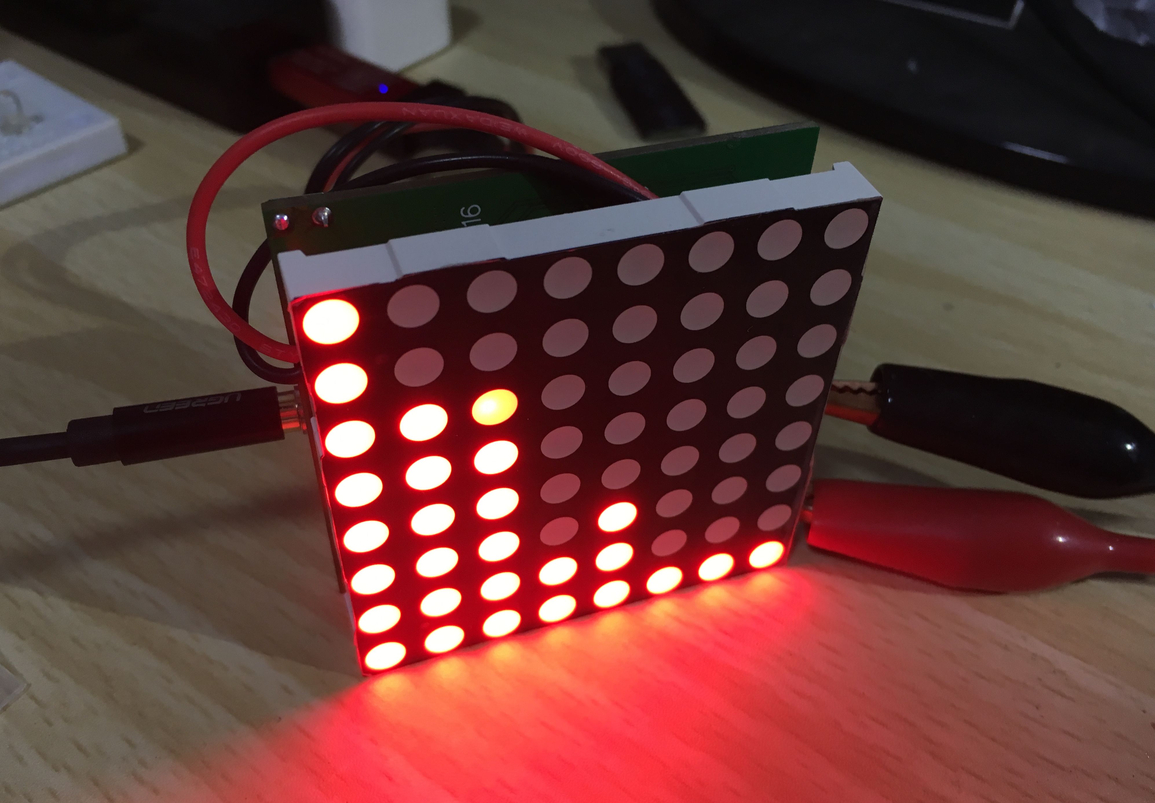

8x8 dot matrix spectrum light
A dot matrix spectrum light based on STM32F103C8T6 can be used as an accessory to the speaker to make your music melody move.
characteristic:
  • Based on STM32F103C8T6, sufficient performance space is reserved to facilitate future expansion of functions.
  • Red 2088B dot matrix, driven by MAX7219, convenient for programming
  • Standard 3.5mm audio interface, powered by USB.
  • An integrated power supply/audio interface is reserved for further DIY
  • Spectrum analysis and display based on FFT, non-level display
  • Adjustable gain to accommodate small signals
  • Flip the display by pressing the button, making it easy to switch the position of the audio interface left or right.
Demo video:
https://www.bilibili.com/video/av82770831/
Welding and usage precautions:
  • J1 and J2 jumpers are used to select whether the input signal is a left channel signal or a right channel signal. They cannot be left unconnected or shorted at the same time.
  • The input voltage should not be higher than 5.5V
  • R8 on the board is used to adjust the gain, the maximum gain is 10
Some notes on the source code:
  • The text encoding of the source code is UTF-8. If garbled characters appear, please modify Keil's editor encoding settings.
  • The source code is generated by STM32CubeMX and written based on the HAL library
  • FFT uses ST's official DSP library, with a sampling rate of 20KHz and a frequency response range of 10KHz. Perform a 256-point FFT and display 8 points below 5kHz in the common vocal frequency range. Welcome everyone to develop again, such as using a longer dot matrix display
Proofing physical display:
Welding physical display
