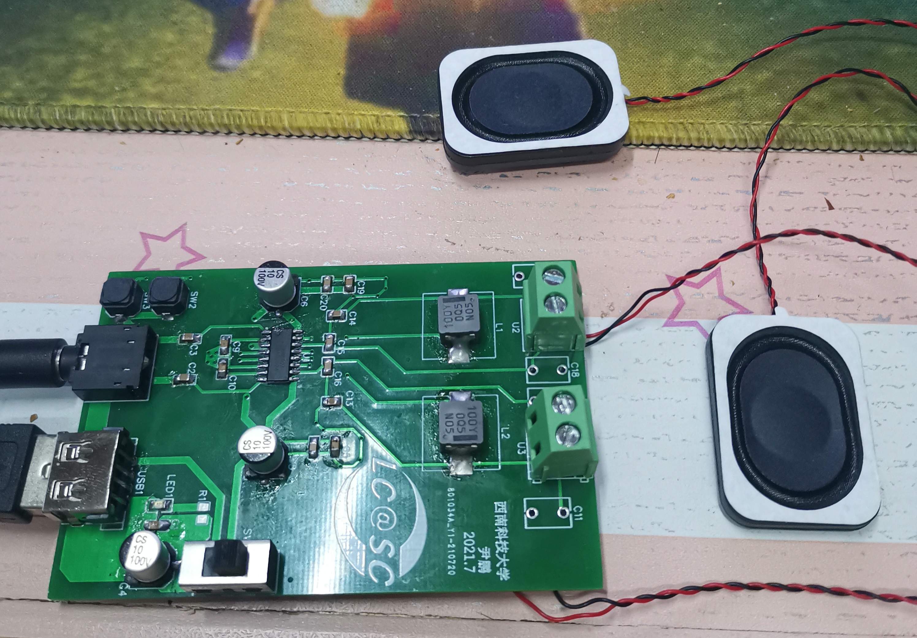

* 1. Introduction to project functions
DIY project, Class D amplifier can drive two-channel 3w speakers. Excellent sound effect, low distortion, small size and easy to carry
USB can be used as a power source and can be used as a mobile phone or computer speaker.
*2. Project attributes
The original project is made public for the first time, and the actual object will be defended at the school.
* 3. Open source agreement
GPL3.0 open source agreement
Please fill in during the competition stage↓
*4. Hardware part
Lichuang EDA,
Power supply part: The power supply interface uses a USB interface, 5V power supply, and the switch uses a patch DIP switch. First filter through the filter capacitor.
Audio access: I chose a 3.5mm plug-in headphone holder, with pin 1 connected to ground, pin 23 connected to the left channel, and pin 34 connected to the right channel.
Audio amplification circuit: PAM8407DR is used as the power amplifier IC. This chip has a pin for adjusting the volume. A touch switch is used as a button for adjusting the volume. A passive filter is connected behind it to improve the sound effect and reduce distortion.
