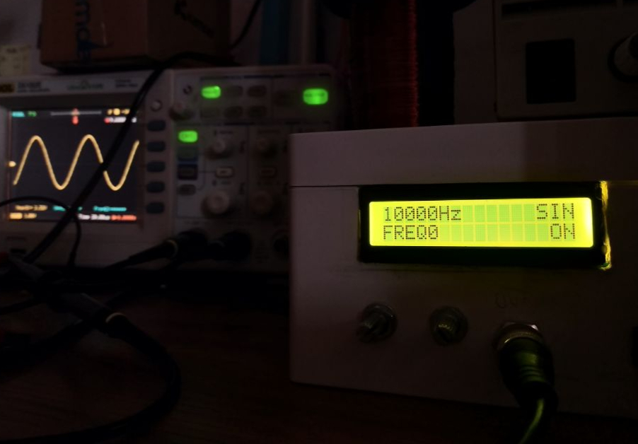

In order to allow more people to make this project, I used atmega328p-au, which is the MCU used in arduino and Cezar projects. The program in this project is designed by me. The user interface is similar to Cezar's version (because on an LCD1602, this layout is the most intuitive and convenient). The purpose of the program is to be easy to use and intuitive. The user interaction interface is LCD1602 and A rotary encoder should be sufficient for this project.
Because it is being produced and the program is being debugged, here are a few pictures of the process being produced.
