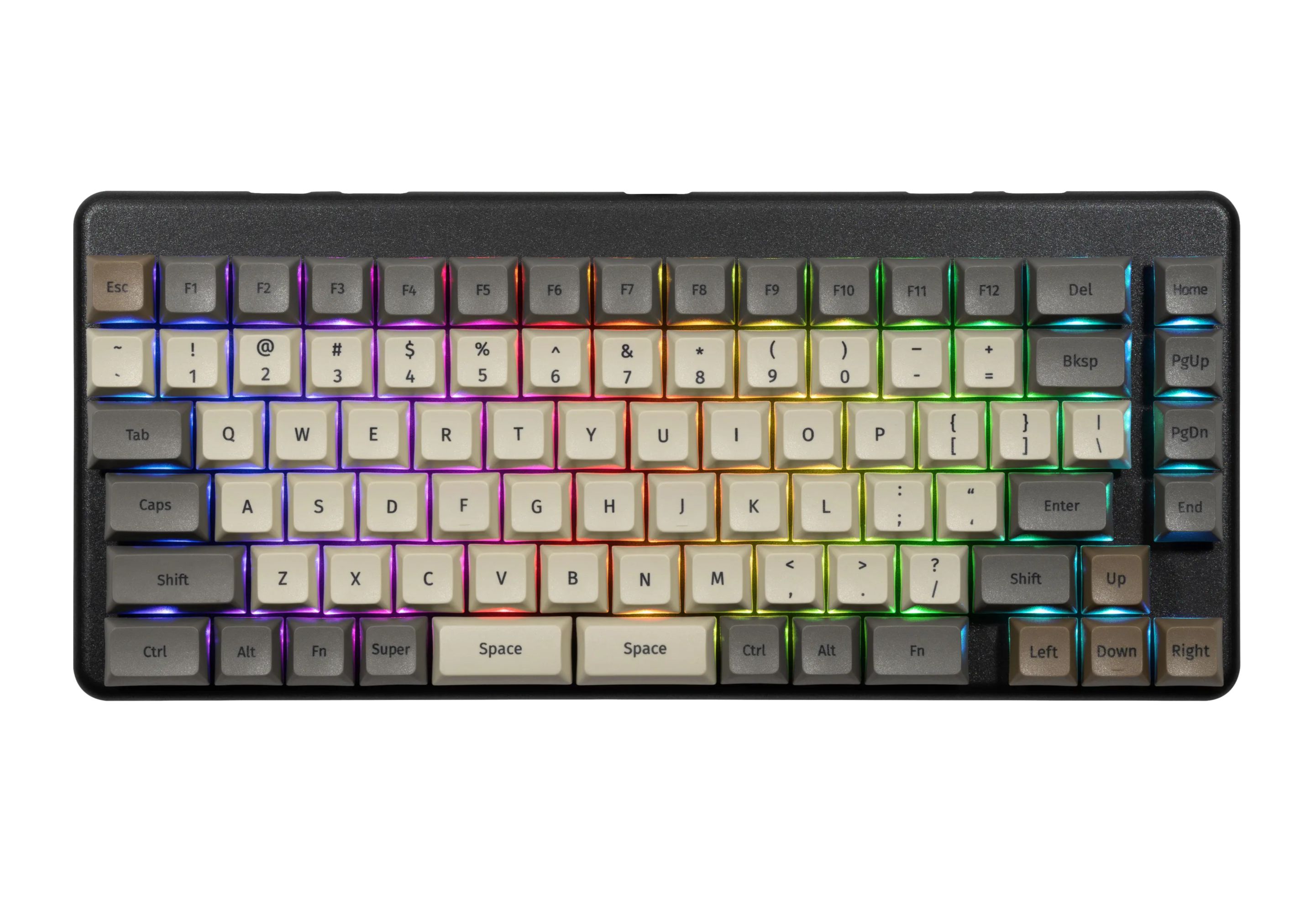

Note: The physical picture shown is of the v1.1 version. The v1.1 version is missing a wire, so you can see that there is a flying wire on the board in the picture shown.
32U4 main control, 84 keys, independent lighting for each key, programmable, hot-swappable, reserved burning port, QMK firmware.
It is implemented with reference to the GitHub open source library of System76 launch keyboard . It has limited capabilities and does not implement the original USB Hub function.
The project description will be updated on GitHub first.
Warehouse address: https://github.com/zsdycs/kb
