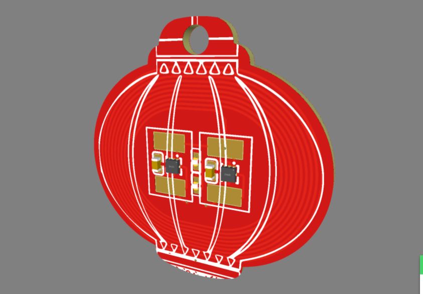

Therefore, here I choose to directly remove the chip in the card. For those who do not need multiple cards, you can add an NFC chip and write data as business cards, WiFi passwords, payment data, etc. to achieve efficient work. The NFC chip is NT3H1101W0FHKH. Just install one NFC chip and uid chip. Each lantern can install two chips! You can install 2 uid chips, or 2 NFC chips, or 1 NFC chip and 1 uid chip!
