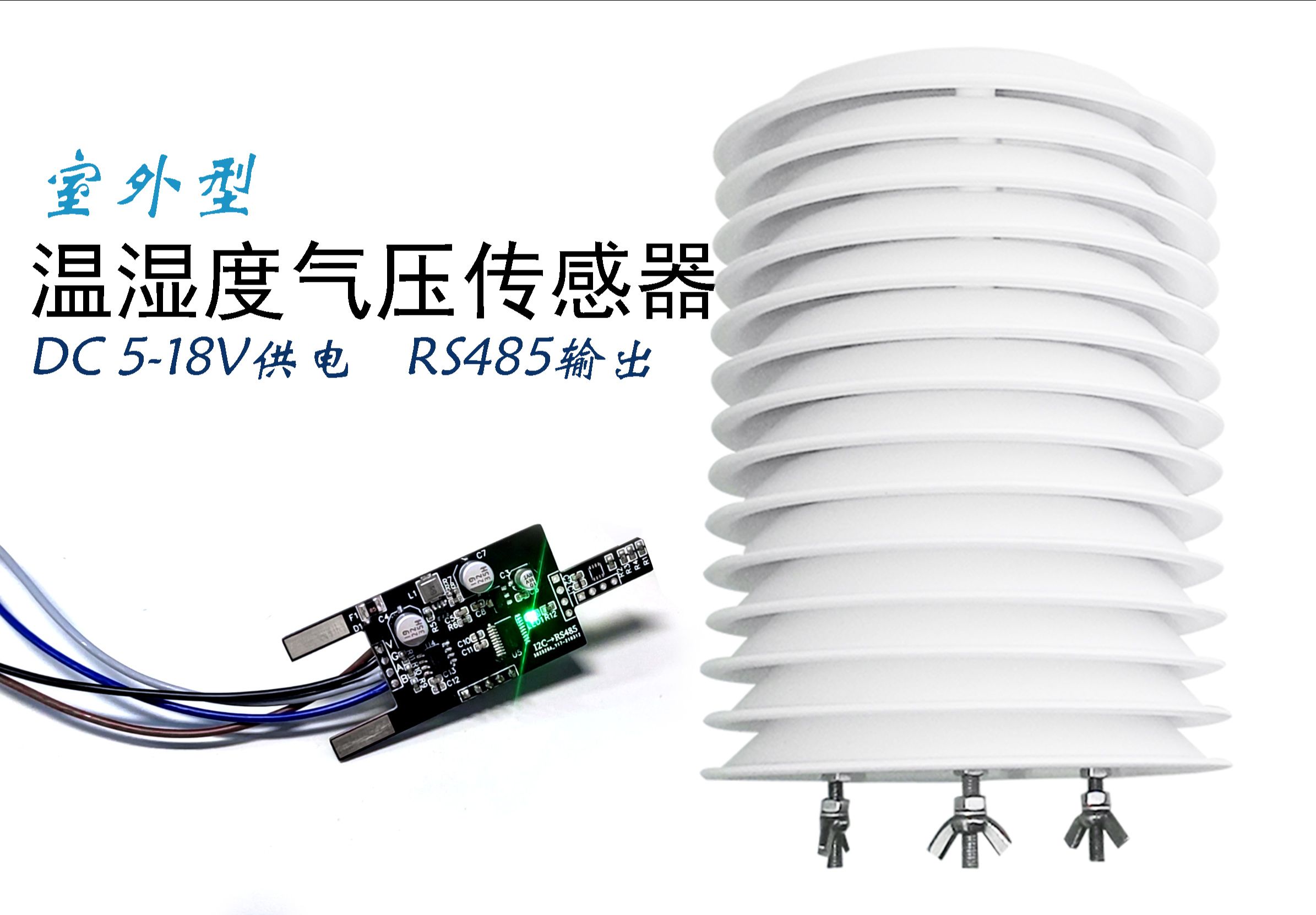

Design summary
This project is a very simple application. It is mainly used for converting I2C to RS485. It is a sensor conversion module. This project is to digitize the I2C signal of the temperature, humidity and air pressure sensor and output the RS485 signal to facilitate the integrated development of other instruments.

4. Shell selection
If you search for "louver temperature and humidity sensor housing" on Taobao, you can quickly find a housing similar to the author's. Plan the PCB according to the internal dimensions of the housing.
5. PCB precautions
The temperature, humidity and air pressure sensors should be placed as close to the side as possible, and a tiny fan can be added if conditions permit. The sensor should be kept away from internal heating components (such as power chips, power modules, buck chips, etc.). The case is placed in the corner. Designed with 4 wires (pin and female positions), you can also break the board and connect it with wires to completely isolate the PCB from heat conduction. Sensor location.jpg
Welded finished product
1. There are various methods. Currently, the author uses the "teppanyaki" method. First, apply solder paste, stick it on, and then heat it with a "whirter".
2. After completing the power-on test, first use a multimeter to check whether VCC (5V3.3VUSB) and GND are short-circuited. Make sure before plugging in. Do not plug in if there is a short circuit. Welding comparison.jpg

product assembly
I found an abandoned shutter box in the corner of the warehouse and assembled it. The two pads drawn on the PCB were just used to weld on the copper pillars, and the copper pillars were fixed on the shutters. As shown below: Assembly.jpg
