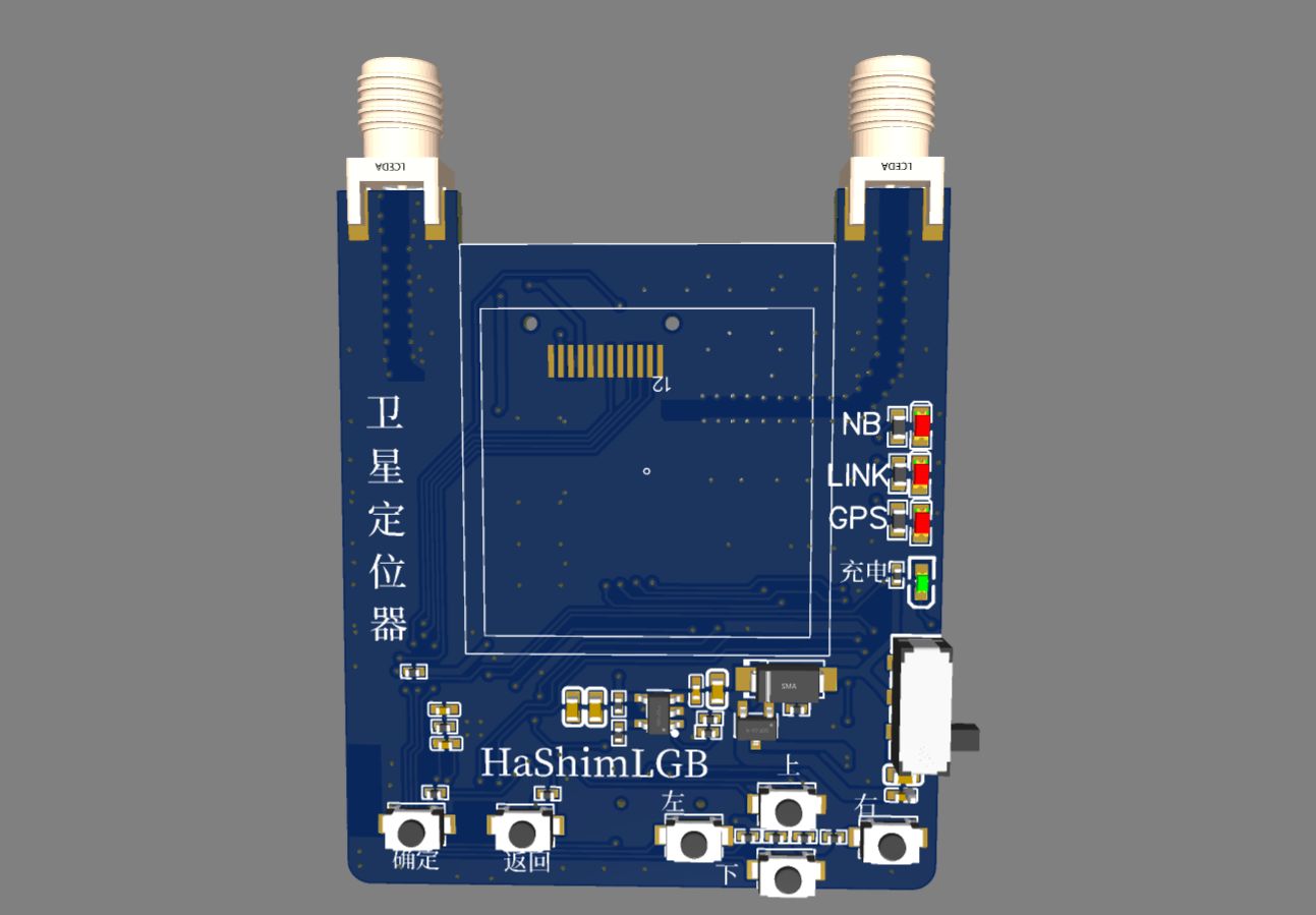

The full name of this work is HaShim Location GPS-BDS positioning display . After the work is completed, the current longitude, latitude, altitude and other information can be displayed locally, and the longitude and latitude can be uploaded to the locator section of the Anxinke WeChat official account at regular intervals. It is expected that the main control of this work will be STM32F103C8T6 (the model may be changed later due to changes in volume), and the positioning module will use Essence’s new EC-01G module. The screen uses a 1.3-inch LCD screen driven by ST7789. I took a look at the operating requirements of LVGL today. It seems that STM32F103C8T6 cannot run. It can only be an STM model with 128K Flash, but that model is really expensive. You can only use ESP32 as the master controller.
