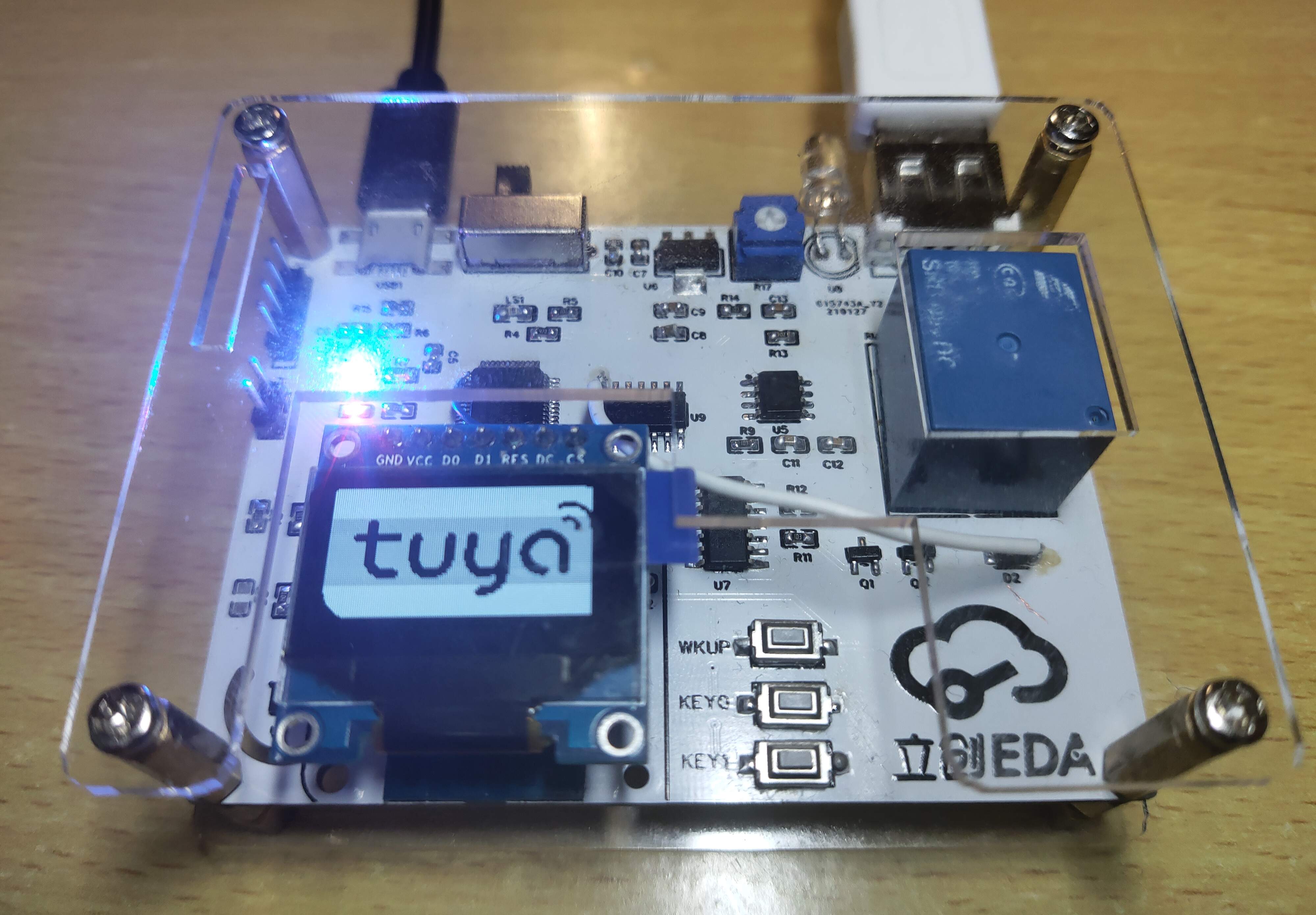

Project function description:
1. Use APM32F030C8T6 as the microcontroller and MDK5+HAL library as the development platform
2. Use Tuya smart module WB3S to connect to Tuya platform, and the APP adopts custom template configuration
3. Use SHT30 as the temperature and humidity sensor to sample the temperature and humidity.
4. OLED serves as a display screen to display the current ambient temperature and humidity.
5. Use 555 timer circuit to output infrared carrier wave to control air conditioners and other home appliances.
6. Use the photoresistor to detect the ambient light intensity to adjust the brightness of the OLED.
7. Use a relay to drive the USB port to control external USB devices

As expected, the car overturned, and I could only cut the board + flying wires. I didn't pay much attention to the drawing board for the first time. One was because the infrared emission pin was not connected to the microcontroller pin, and the other was because the relay power supply was connected to 3.3V. Cannot drive 5V relay.
The final picture of the completed welding is as follows:
