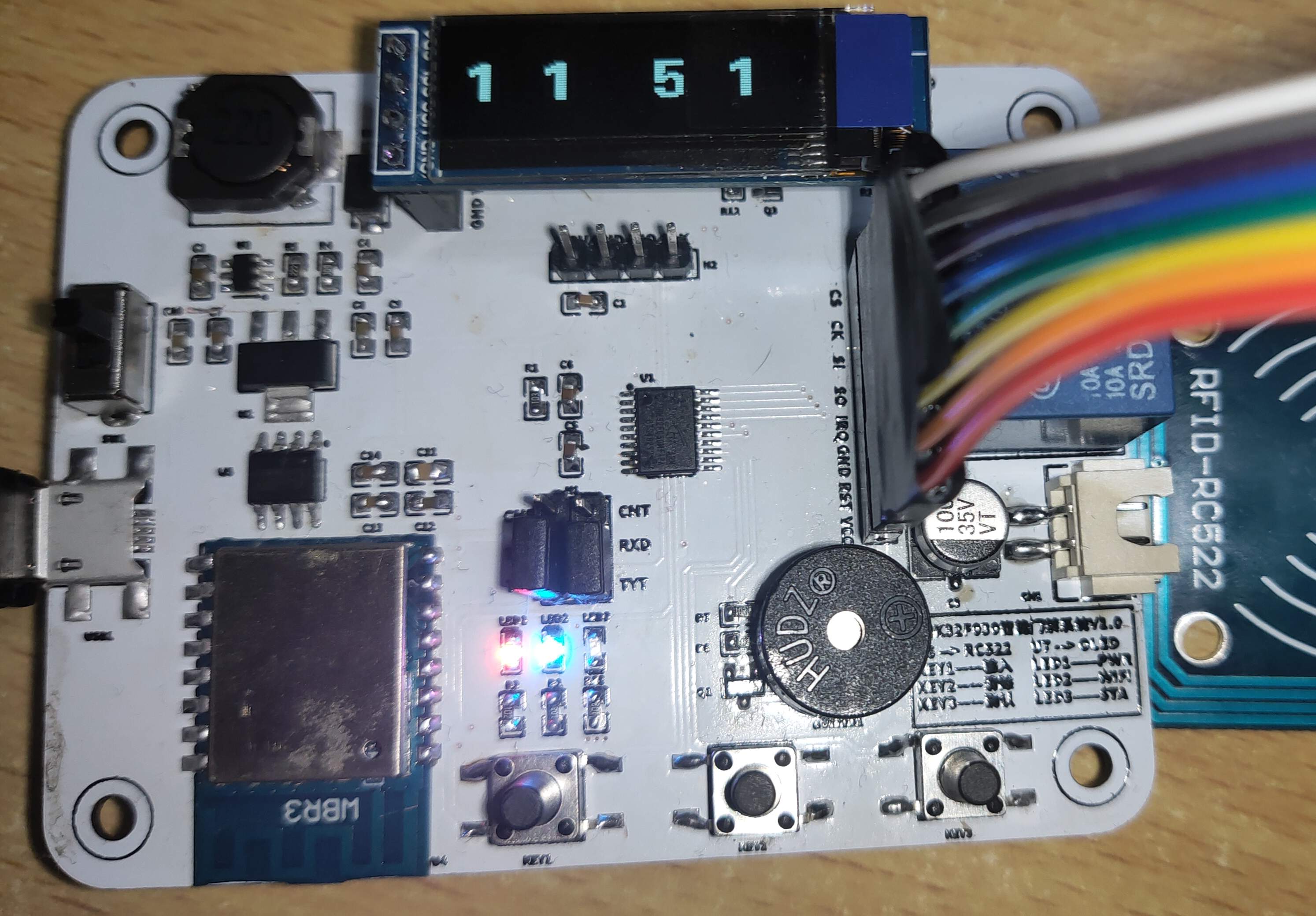

The current physical picture is as follows:
Function implementation:
Connect the external power supply, enter the system, and select the three modes of administrator/card door control/smart door control by pressing the button.
When KEY1 is pressed, the system enters the administrator mode. After entering the set administrator password, the user can enter and delete user information according to the ID card, enter the card password, and set the user name corresponding to the card. After the setting is completed, the user data It will be saved to FLASH, and user data will be loaded from FLASH every time it is powered on.
When KEY2 is pressed, the system enters the card gate control mode. When the card reader module detects an external card, after detecting the card, if the ID card has been entered into the system, the password interface is entered. The user presses the keys KEY1~KEY3 (input, Confirm and clear) to set the entered password. If entered correctly, the buzzer doorbell will sound and the electronic lock will open.
When KEY3 is pressed, the system enters the smart door control mode. At this time, the system communicates with the Tuya module. When the WIFI indicator light is on, the user can connect to the Tuya module through the APP. Intelligent unlocking can be achieved through the switch on the APP interface, and The system will also obtain the current time data through the Tuya module and display it on the OLED screen in a rolling refresh manner.
Physical demonstration:
See Appendix 1 for the administrator mode, and Appendix 2 for the other modes. Since the electromagnetic lock has not yet arrived, the indicator light is used instead of the effect, and the buzzer is used to ring.
