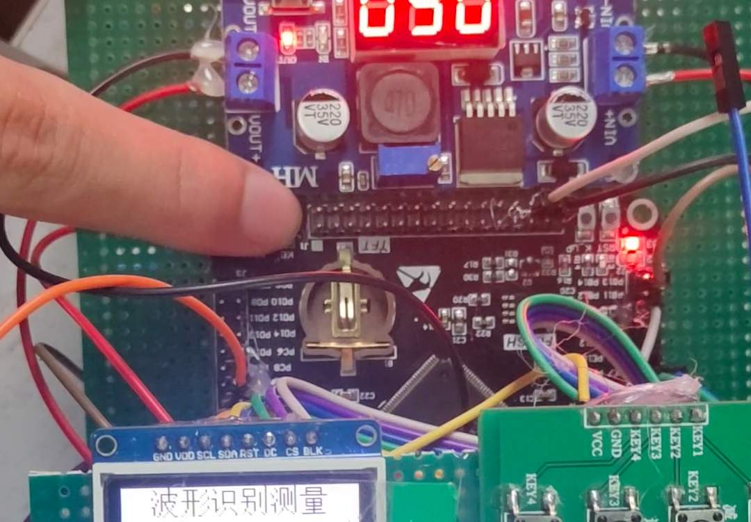

The following is the microcontroller development board and 5V power supply block used: The stm32f407VE board used was purchased online. The schematic diagram is attached and the link is attached, so I will not draw it.
Development board purchase link: [https://m.tb.cn/h.f8qSFPF?sm=25c03f](https://m.tb.cn/h.f8qSFPF?sm=25c03f)
5V power module: [https: //m.tb.cn/h.fjLDGHV?sm=53b407](https://m.tb.cn/h.fjLDGHV?sm=53b407)
Screen module used by the program: [https://m.tb.cn /h.fjpRMgi?sm=5c4546](https://m.tb.cn/h.fjpRMgi?sm=5c4546)
Because the development board comes with 5V to 3.3V conversion and some storage circuits, a lot of hardware is saved during the competition. Just do the wiring directly.
How to wire?
The dual-channel adjustable power supply is connected to the +- power supply (as shown in Figure 2-1). Because the op amp requires +=12V, adjust the two power supplies to 12V according to the following connection method: the left is +12V, the middle is GND, and the right is -12V.
12V is connected to the + of the power module, and GND is connected to GND.
This is an adjustable power module and directly press + -Just adjust the output to 5V for the microcontroller development board.
As for the screen, this time I used a 1.8-inch TFT screen. Because the performance part needs to display parameters at the same time, the screen needs to be larger.
The overall wiring diagram is shown in Figure 2-2.
