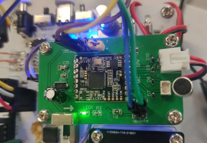

Output instructions through the serial port
Note that the case selection corresponds to the command word id:
Click compile
After success, there will be a user.bin
Let’s merge the partitions again
Then click Package Upgrade
Then click Upgrade Firmware
Use a jumper cap to short the upgrade interface
Re-insert and unplug the GND of the serial port tool
Just wait patiently for the download to complete.
