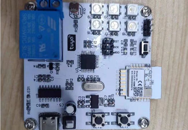

Tuya Smart_Arduino development board

1.  Use Tuya serial port debugging assistant to simulate MCU docking with Tuya CBU module to implement network distribution.
Use USB_TTL to connect to the CBU module, baud rate: 9600
(Result: The test distribution network is normal)

2.  Arduino programming boot program (that is, programming the program downloaded from the serial port)
Reference tutorial: https://blog.csdn.net/y511374875/article/details/79086301
3.  How to realize communication between Arduino soft serial port and Tuya CBU module
Change part:
SoftwareSerial mySerial(9, 10); // RX, TX
TuyaWifi my_device(&mySerial); // Use soft serial port
mySerial.begin(9600); // Software serial port initialization
The rest of the code is consistent with the hardware serial port
