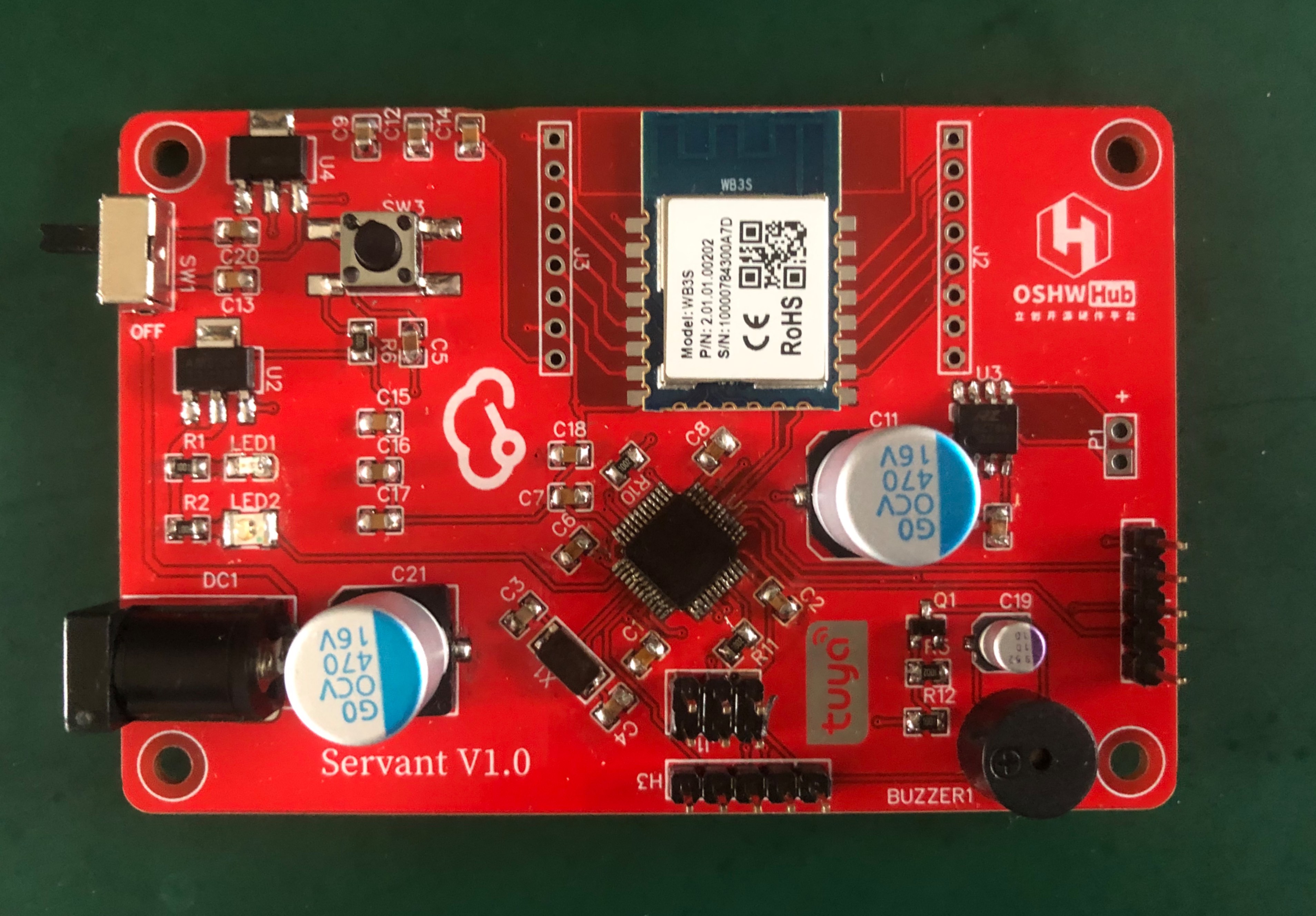

Based on the Tuya IoT smart door lock, I was very excited when I first heard about the free engineering project. But I didn’t expect that the course would be followed immediately by the start of the project. This is really difficult for me, who has no experience in the project. I was totally confused. I started by learning about the power supply circuit. Then I made a board and covered it with copper to connect the power supply and the ground. Then I made the board again. It was a difficult journey, but luckily I made it.
First, I connected 12V to the motor drive and 3.3V to power the chip and module (first reduce it to 5V and then use 1117 to 3.3V)
AMS1117 internal diagram
power circuit
STM32 chip
I chose the mcu development solution, using the STM32F103C8T6 chip

Motor drive circuit
pwm output diagram
If it is detected that it is greater than CCR, it will be judged as high level, otherwise it will be judged as low level.

welding gun
It was my first time to hand-solder a patch. It was quite interesting, but the chip was too small and the equipment couldn't keep up. It took me a long time to solder it.

Photo of motor and board
Before you buy a motor, use a small motor to simulate it first. If you want to open and close the door, it is more reasonable to choose a 180-degree motor with high torque.
