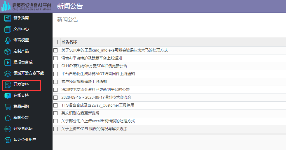

3. As shown in the figure below, select "Development Data" on the left menu bar to enter the main interface of development data;
Entrance

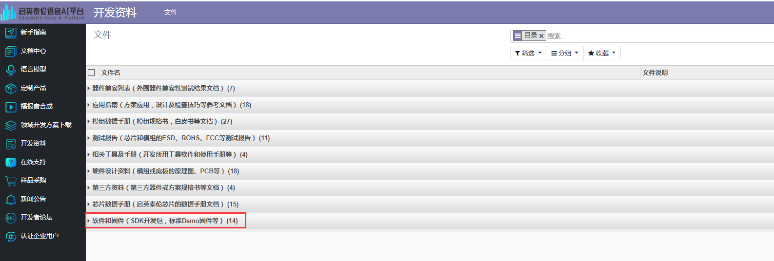

4. Step 3: As shown in the figure below, select "Software and Firmware (SDK Development Kit, Standard Demo Firmware, etc.)";
download
5. Select the SDK version you need to download, as shown in the figure below (this figure takes "CI112X_SDK_V1.2.9" as an example);

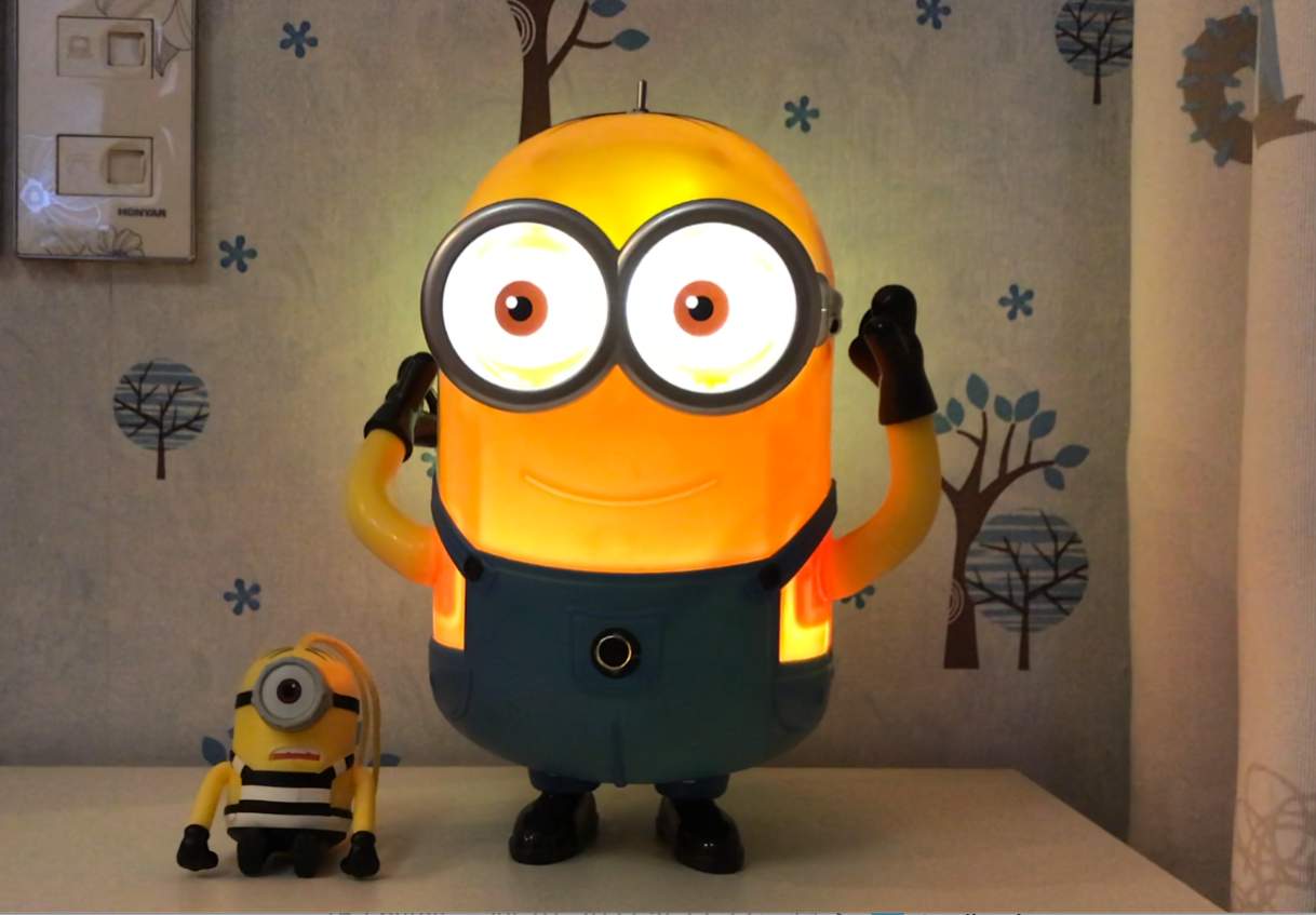

Soldered Boards (4th Edition)
re5DhwameVMnCkFC3xLw6k3naxl6YB4qT8diHZTM.png Oh1tSiuJcXeRNsnMesV0t4sJrLAdXQJ1wBA67O3I.png
 Internal and external pictures of Minion after installation
I5uce0sqFY6NzFUa71rGg7SfERSP32UVNbzLqoqr.png jt1vO1MpefOtbtmmaFnxyOmuwT94iuReegbIXoTc.png IhZALeurTu1ZcUenmxFmTjWpEj7y3xqZ5VeXfNti.png
