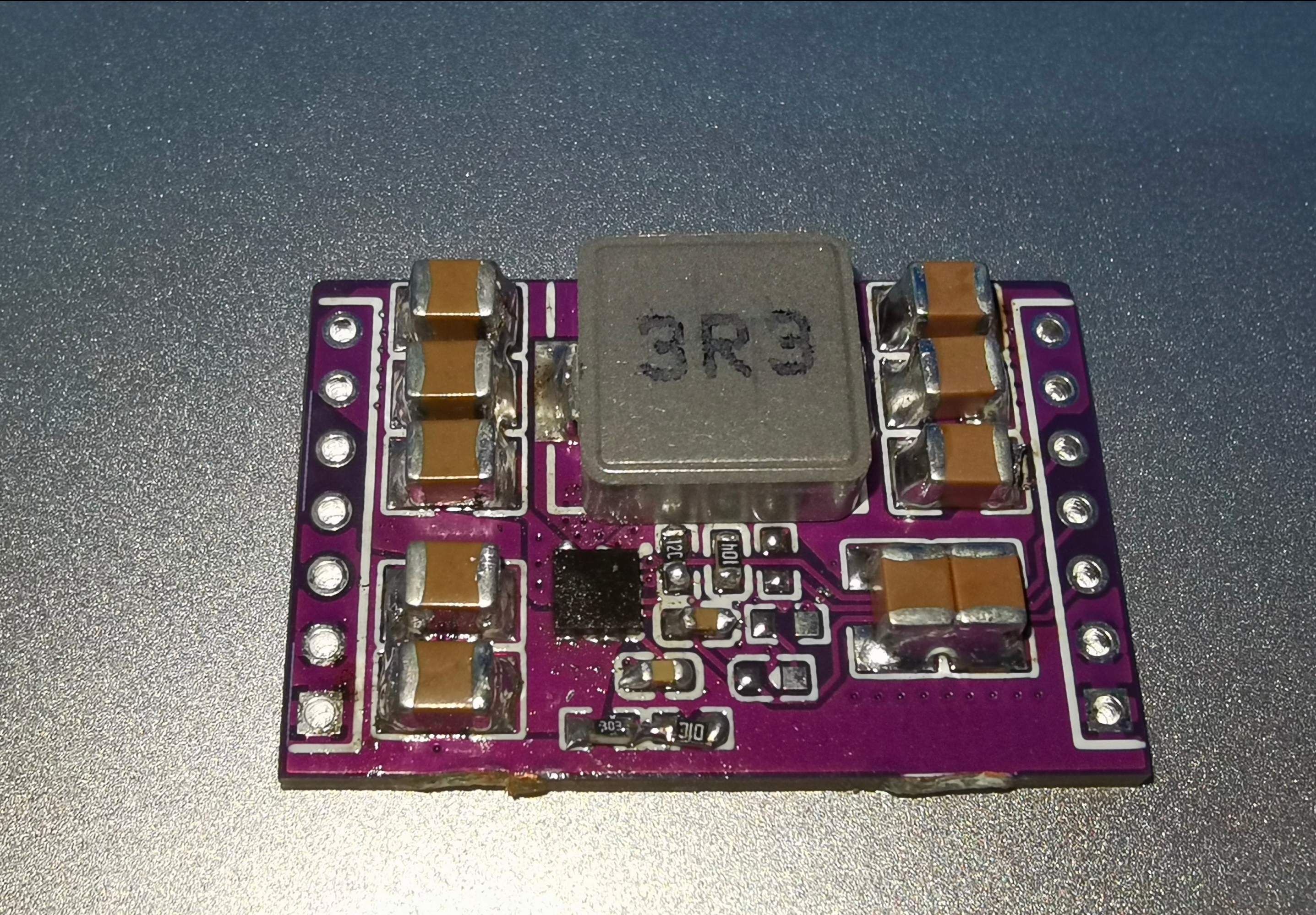

4-23vin, 5Aout, all parameters are the same as mini560, including fb, en and pg. The upper arm of fb network is 100k, and the default output is 5v. It can be easily matched with various fast charging protocol chips. The cover picture is sy8368. Before 8286 could be welded, 8368 was used to top it. In theory, the appearance will be similar after welding.
