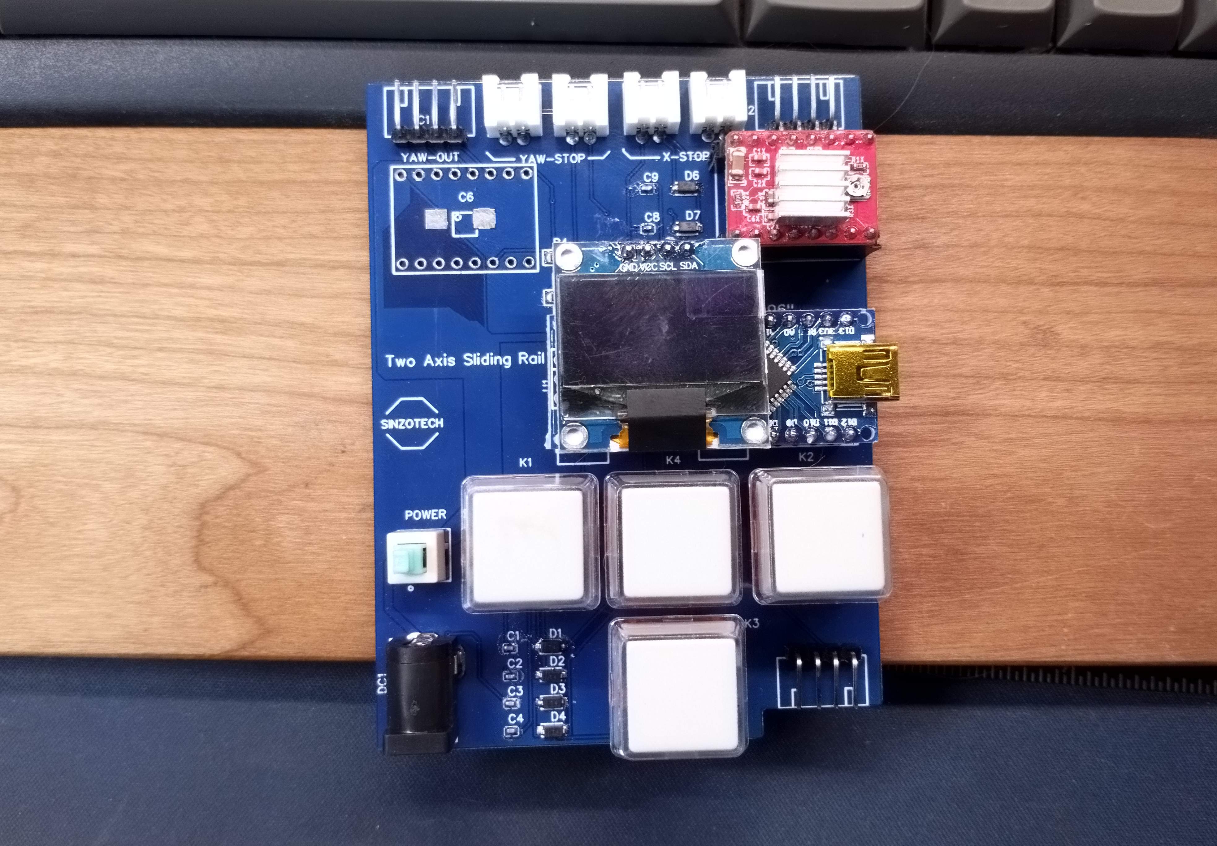

This design can easily control two stepper motors, and I introduced subdivisions to facilitate digital control (mostly manual settings on the market), and uses a lot of modularity, so it is very easy to damage parts such as those caused by electric shock. The stepper motor module and main control can be directly replaced, while the analog components that are not easily damaged are directly onboard.
Using such a board, you can easily develop a practical two-axis gimbal, similar to this, and the price is not too high.
