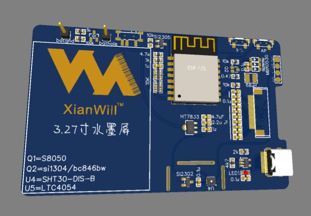

Thanks to Bantang, Duck and other big guys for the open source.
  1. Use a four-layer board. (It is recommended to use jp for free)
  2. Optimize the layout of the original and streamline the original.
  3. Omit the onboard ch340c and use a burning folder to burn.
  4. The PCB leaves a lot of space for later upgrades.
  5. Please use the lower connection for fpc seat.
参考设计图片
