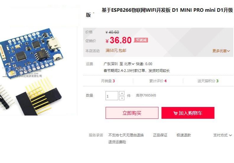

I have never seen a new version of the ship nodemcu
Features:
  • Relatively small in size and good looking
  • All are made of 0603 and can be hand welded.
  • Use USBLC6-2  ic for ESD protection, if you don't need it, no need to solder, this will not affect the working of the serial port
  • TYPE-C connector supports positive and negative insertion
  • There is an M2 hole around the PCB for easy fixing (can be used as a key chain)
  • Double-sided PCB layout, board thickness is 0.8mm, size is 33.0mm x 25mm
  • Originally nodemcu used module welding, with a total of 4-6 layers of PCB, but now only two layers are used! thickness- - -
  • Pin to pin with D1 mini development kits Pin to pin with D1 mini development kits
  • Use the cheap and high-quality ch340c (it squeezes me to death www)
  • Didn't use ceramic antennas because they cost a dollar each.
