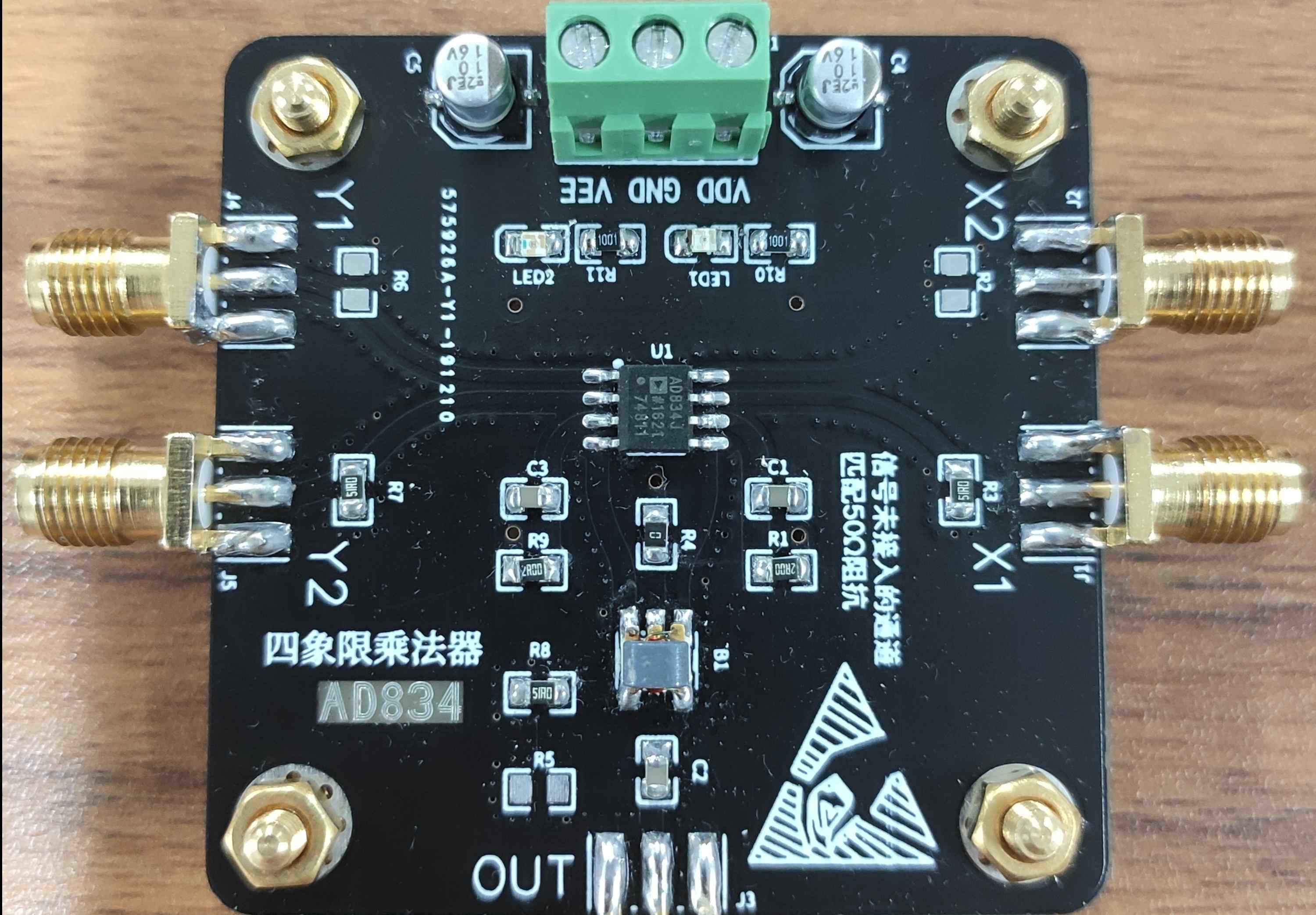

The four-quadrant multiplier uses the AD834 multiplier chip to realize the multiplication operation of 4 channels, and the bandwidth can reach 500MHz. Since the output form of the AD834 chip is a collector differential current pair, an unbalanced-balanced transformer ETC1-1-13TR is used at the back end of the circuit to convert the double-ended current output into a single-ended voltage output to facilitate the next-level coupling of the signal. and observations.
Physical map: IMG_20191223_172319.jpgIMG_20191223_153722.jpg
Test results: The fundamental wave signal is a sine wave with a frequency of 1kHz and an amplitude of 2V. The carrier signal is a sine wave with a frequency of 1MHz and an amplitude of 2V. 22222.bmp
