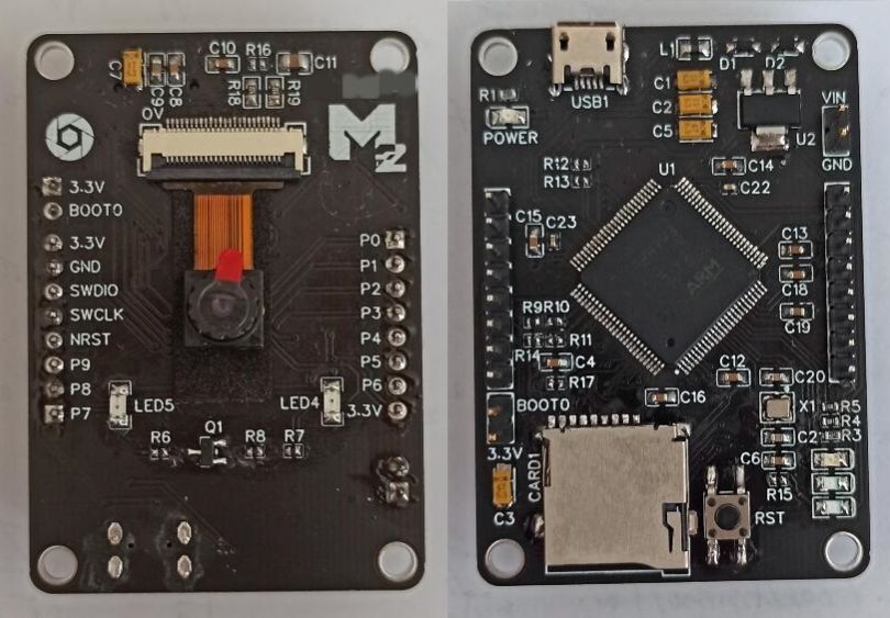

The sample pictures and finished product pictures below are from the previous version. The open source version has been slightly modified based on it. Based on the current version, there will be no big difference. Recommended black board to prevent light leakage. (It is soldered with a soldering iron, there is no washing water, and my photography skills are not good, so let’s just take a look at it...)
Empty board front and back
Finished product front and back
