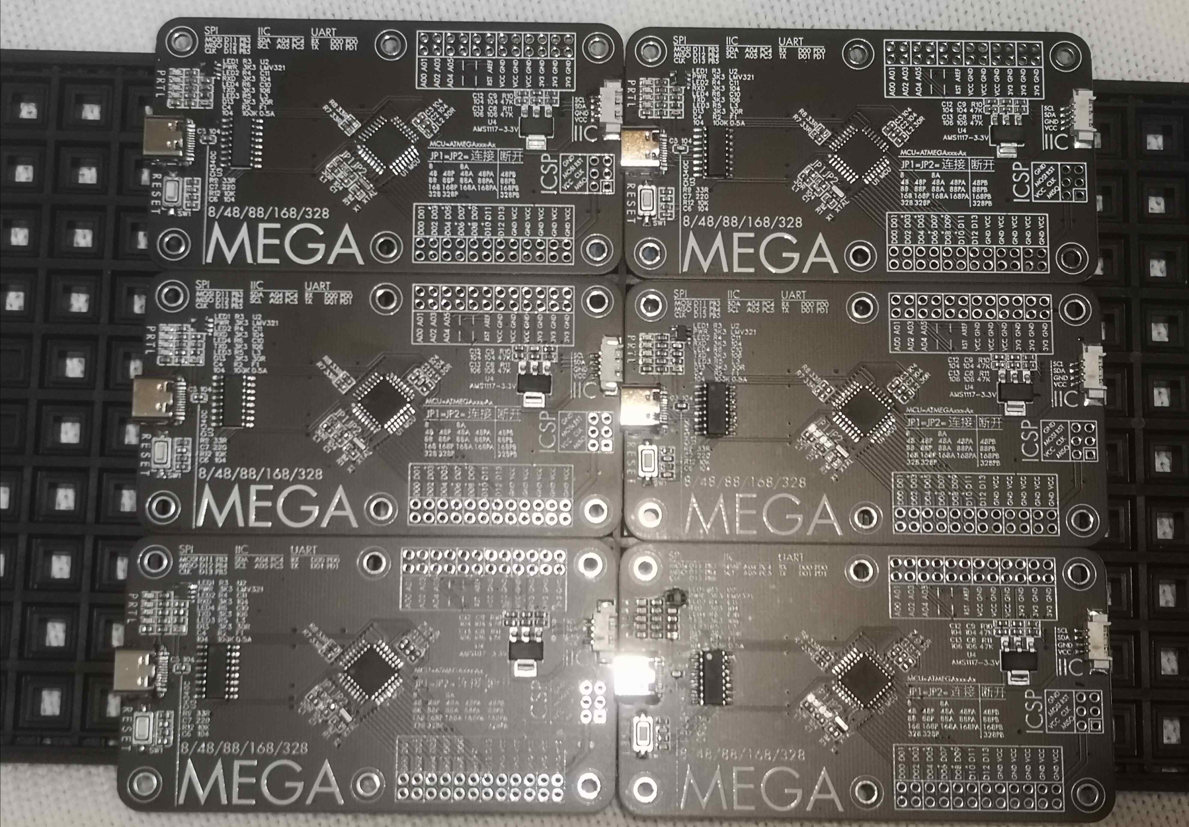

Compatible with ATMEGA (8, 48, 88, 168, 328) ( blank , P, A, PA, PB)-Ax chip, onboard USB to UART, 3.3V output, leads to ICSP and IIC interfaces

The silk screen on the physical picture is wrong and has been corrected in the PCB. If the schematic diagram does not match the number, description, etc. of the PCB, the PCB shall prevail.

For the trouble of identification during secondary use caused by multi-chip compatibility, an area is designed on the back of the circuit board to mark the chip and crystal oscillator information. Please use a marker or paint pen to write (the problem of difficulty in writing on the solder mask has been fixed):
