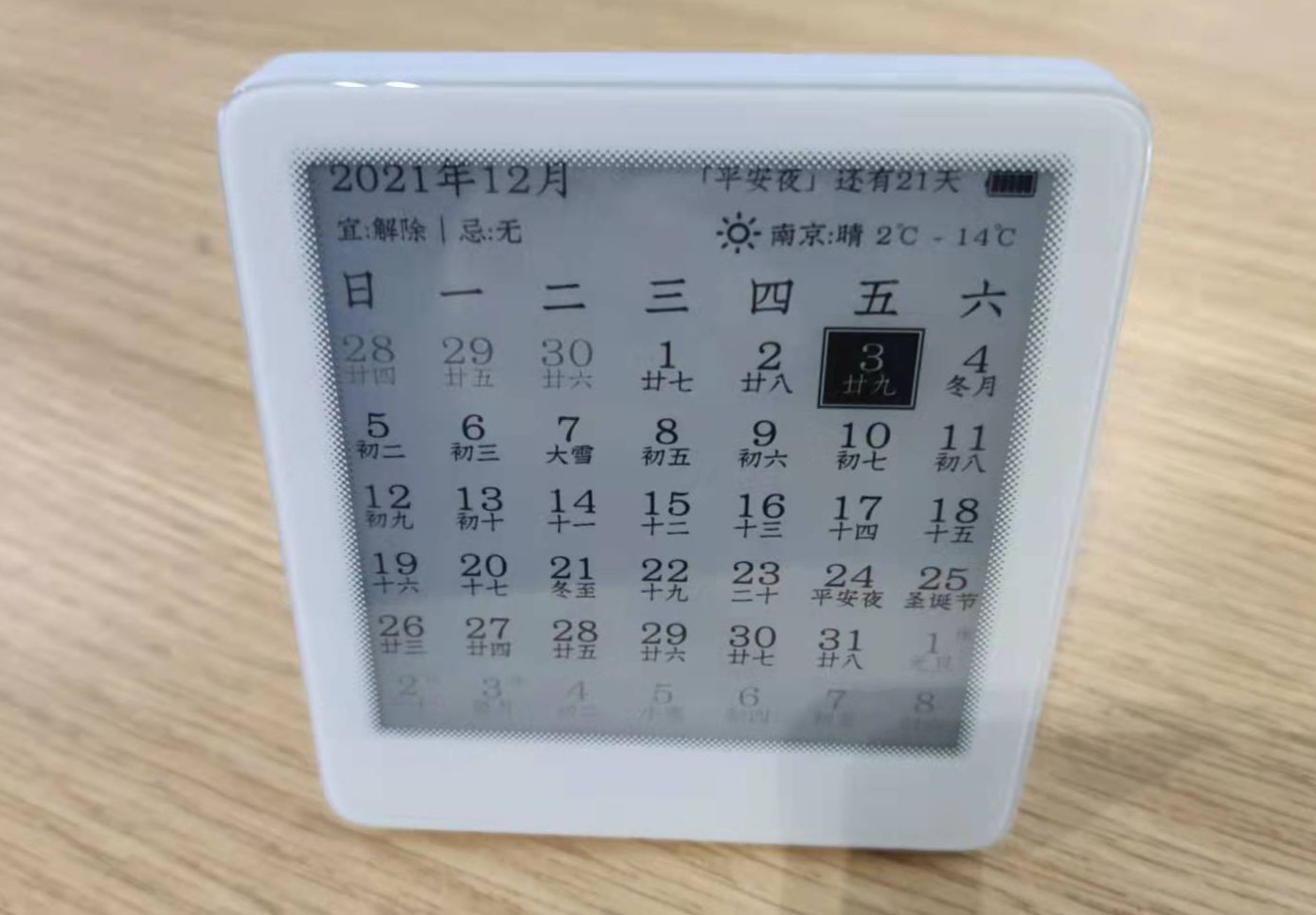

Calendar interface
Calendar function description
  • Basic calendar functions (today’s date, week, month)
  • lunar calendar
  • Taboos in the Huangli calendar
  • Twenty-four solar terms

[x] Schematic design [x] PCB diagram design [x] PCB proofing [x] Welding test [x] Functional test [x] Program test
The calendar is currently in use and uses a small 400mAh battery. Since updates are not very frequent, it can basically be charged once every six months. If you use a large battery, you basically don’t need to charge it, which meets the design requirements.
