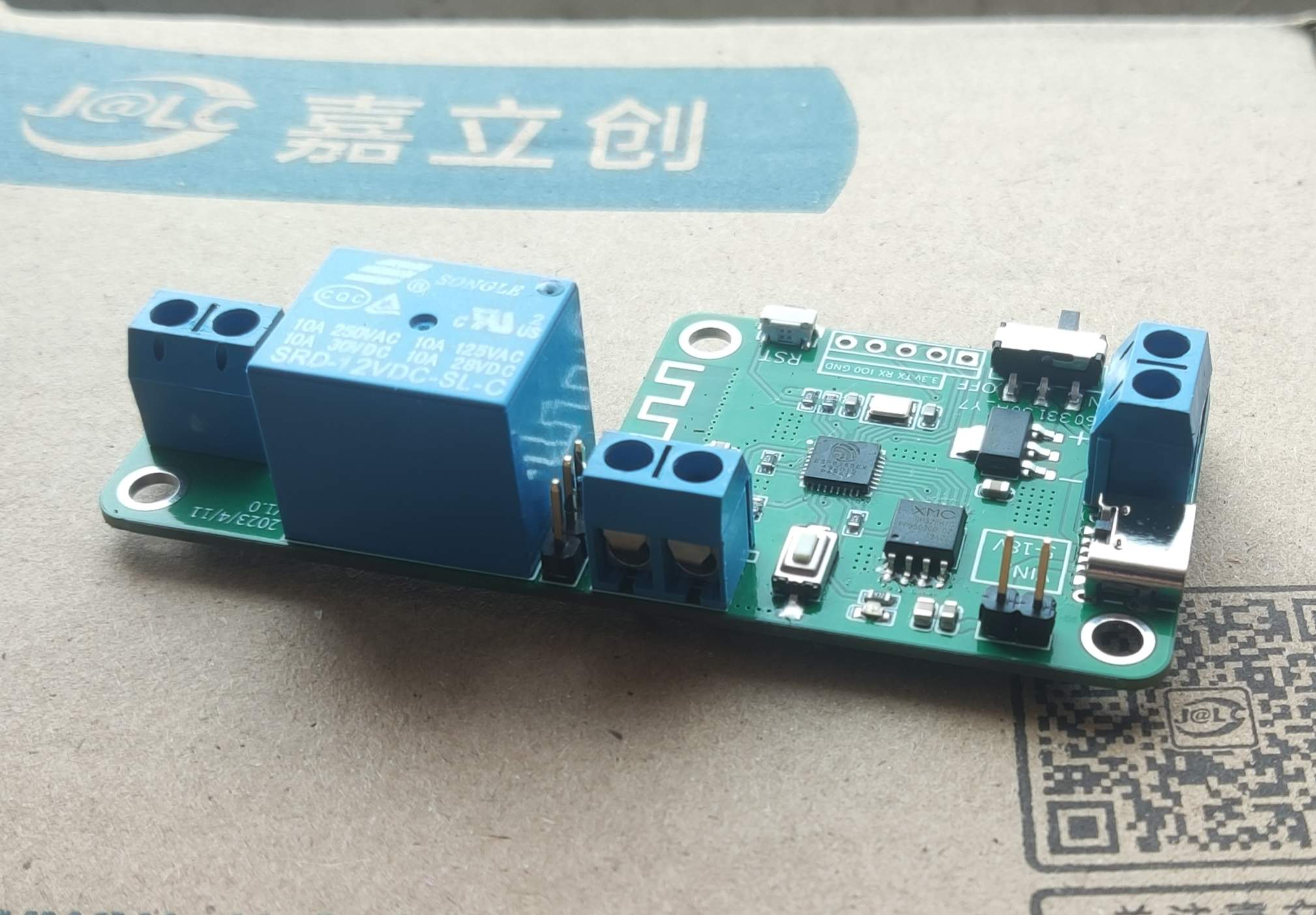

The module is a wireless relay control module based on the ESP8266EX chip with 12V voltage input. It is connected to Blinker in the program, which can realize the on and off control of the relay by mobile phone and voice. A set of control lines are drawn in the module, and the relay can be turned on by short-circuiting without going through the network. The specific instructions are as follows:
Physical picture:
Schematic diagram:
1. The red part is the relay output end. When the relay is energized, the two ends are connected. The relay is controlled by a transistor. The ESP8266EX outputs a high-level relay path and the low-level relay is disconnected.
2. The yellow part is the relay jumper end. When the two ends are connected, the relay is not controlled by the microcontroller to be energized, and an external switch can be connected.
3. The orange part has two buttons. The upper button is connected to the RST pin of ESP8266. When pressed, the single chip restarts. The lower button is used for logic detection. When the microcontroller starts, press and hold this button and the device enters the network distribution mode.
4. The green part is the power input terminal, which is usually 12V, and the optional range is 12V-5V. Please change the relay specifications according to the different input voltages to avoid the relay failing to attract. There are three types of input power terminals, please choose one.
5. The blue part is the power switch, which controls the input power on and off.
6. The purple part is the microcontroller program burning pin, please prepare a TTL burner by yourself.
