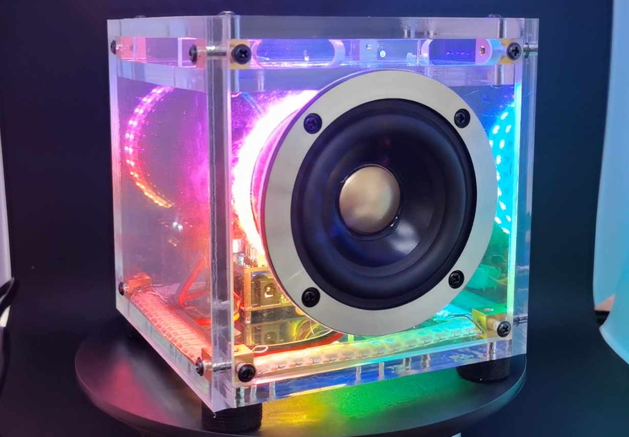

Labyrinth Desktop Music Rhythm Speaker-Yue-2.0
The lights move with the music, and the invisible sound allows our eyes to feel the beauty of the sound through the rhythm of the lights. The beautiful human voice and the gorgeous lights blend together, giving us the ultimate experience for our ears and eyes.
Search and watch high-definition videos on Station B
Features: 1. Labyrinth box, improves the lower limit of low frequency and reduces distortion
           2.Colorful lighting effects
Function: 1. Musical rhythm
           2.24 lighting effects
           3. Click the button to switch modes
           4. Long press the button to turn on or off the light
           Switch a rhythm color in 5.5 seconds
           6. The light show mode switches the effect once every 8 seconds, and click the button again to lock the current mode.
           7. Automatically switch to wait for light effects when there is no sound
Yue-2.0 has excellent sound quality, beautiful vocals, powerful bass, and cool lighting. The labyrinth structure replaces the traditional closed box and effectively reflects the sound waves (negative phase waves) generated by the speaker's backward vibration through the labyrinth. Backward, it is superimposed with the forward wave generated by the forward vibration of the speaker. The amplitude increases and the sound becomes louder, achieving the effect of stronger bass and more realistic vocals.
DIY gameplay
On the light strip, you can replace the 60 pcs/m light strip with 144 pcs/m for a smoother rhythm. You can also install a light strip on the side edge of the speaker for a more three-dimensional effect. Or replace the entire side with a music spectrum, etc.
In terms of program, you can change the color of the rhythm in the program according to your own preferences, or change the effect of the rhythm and add more lighting effects.
In terms of control, you can use the esp8266's ability to connect to wifi and write a host computer to control the light color. You can also connect to the cloud platform and connect to the mobile voice assistant to play the role of voice control to switch songs and change light effects.
If you have other ideas, you can DIY it yourself.
