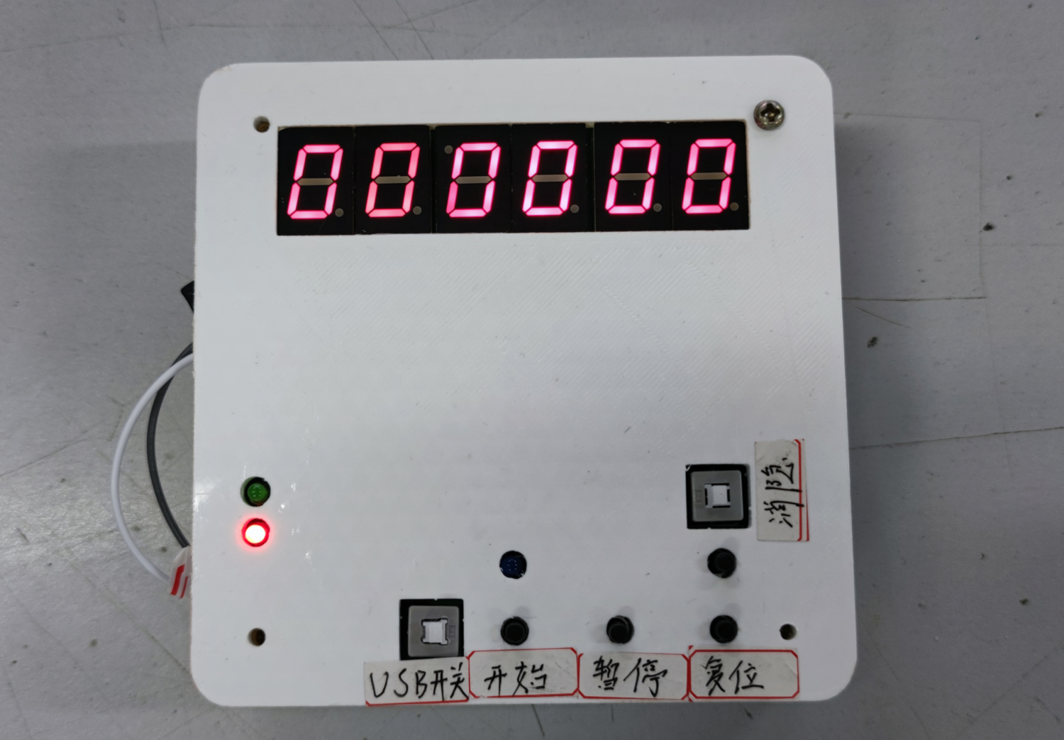

Chapter 1 Design Task
1 Content and Requirements
(1) The simple stopwatch has a display function and can display 0-99 milliseconds, 0-59 seconds, and 0-59 minutes.
(2) It has a timing function. When the millisecond meter reaches 99, it starts again from 0 and the seconds digit advances by 1. When the seconds digit reaches 59, it starts again from 0 and the minutes digit advances by 1. This cycle is repeated and the timing is accurate.
(3) It has a button function. Start button: After pressing, the stopwatch can start timing from 0s. Pause button: After pressing, the stopwatch can be paused immediately at any time and the current timing time can be displayed. Reset button: After pressing, the stopwatch can stop timing at any time and the displayed time will be reset to zero.
(4) It has a function of reporting the time every minute. When the seconds digit displays 59 and 01, the buzzer and light-emitting diode will sound and light up for 1s.
(5) It can control the display and extinguishing of the digital tube, and the timing function works normally.
(6) It can manually set the start time of the minutes and seconds digits.
Chapter 2 Design Plan
2.1 Overall idea:
The design of this topic is to make a counter that can display minutes, seconds, and milliseconds, with power charging function, manual minute carry, second carry function, timing function, hourly time telling function, start, pause and reset function, and backlight function. Then this circuit mainly includes 6 parts: the first part is the power supply and lithium battery charging and discharging circuit, which provides power for the circuit; the second part provides a periodic pulse signal; the third part is a combination counter with the second part as the input source; the fourth part is the display part, which displays the result of the third part in a certain way; the fifth part is the key function part, which realizes start, pause, reset, manual carry, and backlight display through buttons; the sixth part is the hourly time telling part, which tells the time at 59 and 01 seconds by monitoring the signal of the display part.
2.2 Design Plan
Use the synchronous adder counter CD4518 to form a 100-base adder counter as the first-level (millisecond) counter. At the moment when the millisecond unit digit counts to 10, a clear signal is sent to the unit digit, and a carry pulse is sent to the tens digit at the same time. The millisecond ten-digit adder counter sends a reset signal to the current position at the moment of counting to 100, and sends a carry pulse to the second position at the same time. This constitutes a cascaded 100-base adder counter with carry and reset.
The second position and minute position are different from the millisecond position. They are counted in 60-base, so the reset and counting methods need to be changed: at the moment when the second position and minute position count 9, a falling edge carry signal will be sent to the ten position. At the moment when the second position and minute position ten-digit adder counter count to 60, a reset signal is sent to the current position through the AND gate, and a carry pulse is sent to the lower position at the same time. This constitutes a cascaded 60-base adder counter with carry and reset.

3.4 Display circuit
The display circuit uses CD4511 to decode the BCD code of CD4518 and drive the digital tube display. At the same time, a switch is used to control the level of the BI terminal of CD4511 to control the digital tube display. The circuit diagram is as follows
3.5 Button function
The reset, start, and pause functions are realized by using the dual JK flip-flop 74ls112.
After pressing the start button, the 3rd pin (J pin) of 74LS112 is connected to a high level, the 2nd pin (K pin) is a low level, and the high level is output through the 5th pin (Q pin) output terminal to the 74LS08 AND gate input terminal. The other input terminal is connected to the NE555 pulse signal. When the output is high level, the output of the pulse signal is controlled by the AND gate, and the pulse signal is sent to the CLK terminal of CD4518. When the button is released, the JK terminal of 74LS112 will become a low level, and the output of the Q terminal will remain high, thereby realizing the start function.
After pressing the pause button, the K pin is connected to a high level, the J pin is a low level, and the low level is output through the Q pin, controlling the 74LS08 to output 0 all the time, so that the CP terminal of CD4518 cannot receive the pulse signal and pause counting, thereby realizing the pause function.
3.6 Hourly time reporting function
Connect the output of CD4518 to CD4069 and 74LS21 to output high level at 59 and 01 seconds, and use 74LS32 or gate drive transistor to realize buzzer and light-emitting diode to ring and emit light for 1 second at 59 and 01 seconds. The circuit diagram is as follows
3.7 Manual carry function
Connect the carry end of seconds and minutes through the key. When the key is triggered, a pulse signal will be generated, so that CD4518 can count and realize the manual carry function. The circuit diagram is as follows
