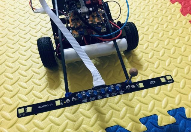

In order to lower the center of gravity of the vehicle, it is necessary to strictly control the weight of the inductor coil and the support frame, and at the same time, the length and angle of the forward look must be considered. We use carbon fiber tubes as the main mast for installing linear electromagnetic sensors, so as to obtain the maximum stiffness-to-mass ratio. The entire device has high positioning accuracy and stiffness, making the inductor coil more stable, thereby reducing data collection errors. As shown below.
In order to clearly monitor the operation of the speed and electromagnetic sensors, we specially installed an OLED display to display the reading parameters, and the parameter values ​​can be remotely controlled through serial port debugging.
This module uses an electromagnetic sensor with six 10mH inductors and 6.8nF capacitors to form a resonance. The collected signals can detect normal signals at a height of more than 2cm from the track, and are transmitted to the onboard LMV358 operational amplifier for amplification and rectification through the output signal interface. to the microcontroller ADC interface. You can see obvious continuous changes in the values ​​collected by the microcontroller at 2-30cm from the center of the track (the actual measurement is more than this distance), and the values ​​detected at the same position are basically stable. It is an ideal electromagnetic sensor for track signals.
