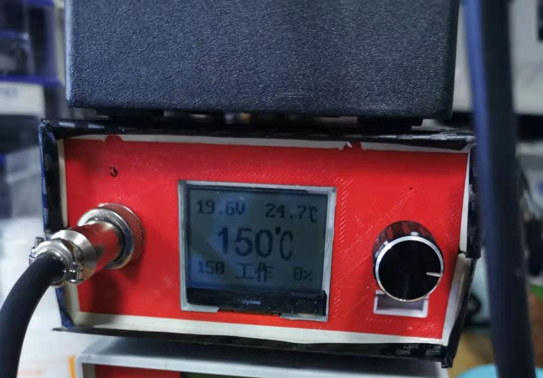

MS51FB9AE-T12 This version is functionally verified and can be used normally! Plus, the wiring can be optimized! MS51FB9AE comes with its own reference voltage! After removing the boot, the capacity is still 14k, which is perfect for making a soldering iron! Compared with N76E003AT, the space is 2K smaller, but it can support up to 24Mhz. The program code is a bit messy. I will sort it out later and release the encoder. The soldering iron aviation head is not integrated, because many of them need to suit your own layout, so you can redraw or fly the lines yourself! The amplification part can be replaced with a potentiometer. I directly connected two 20k in parallel as a secondary amplification screen. I used a 9664. You can replace the screen according to your needs! The encoder part and the screen part refer to the open source code on the Internet, and the T12 heating PID refers to the code of the Internet master, but it has been so long that I really forgot who it belongs to! Sorry! The name used in the menu part: GXD LCD multi-layer menu v1.2.1 Author: China Chuanhui TranSmart gongxd@126.com
The code is not perfectly written, and the comments are not very clear! Let's just deal with it and see. If a master modifies the code, please follow the open source agreement and share it. Thank you! 68608800@qq.com
