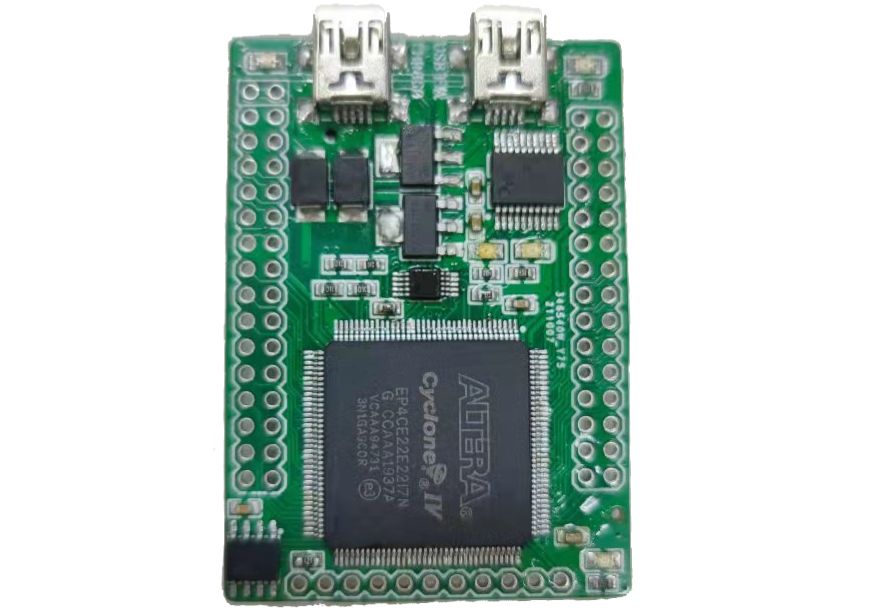

UniPlugS-FPGA
All manufacturing and usage instructions for this board can be found athttps://github.com/WangXuan95/UniPlug-FPGA
  • FPGA model: Altera Cyclone IV EP4CE22E22
  • Integrated USB-blaster (PIC18F14K50 microcontroller solution)
  • USB-UART
  • 2MB configuration flash memory (EPCS16) for storing FPGA configuration
  • 8MB user flash memory (W25Q64) SPI-flash
  • Micro-SD card slot
  • CAN-PHY, used for CAN bus communication
  • 4 user LED lights
  • Three sets of extended IO: IOA, IOB, IOC
    • IOA is 7 common IOs fixed at 3.3V
    • IOB can be configured as 18 common IOs, and the level can be configured as 1.8V, 2.5V or 3.3V using jumpers.
    • IO C can be configured as 18 ordinary IOs, and the level can be configured as 1.8V, 2.5V or 3.3V using jumpers.
