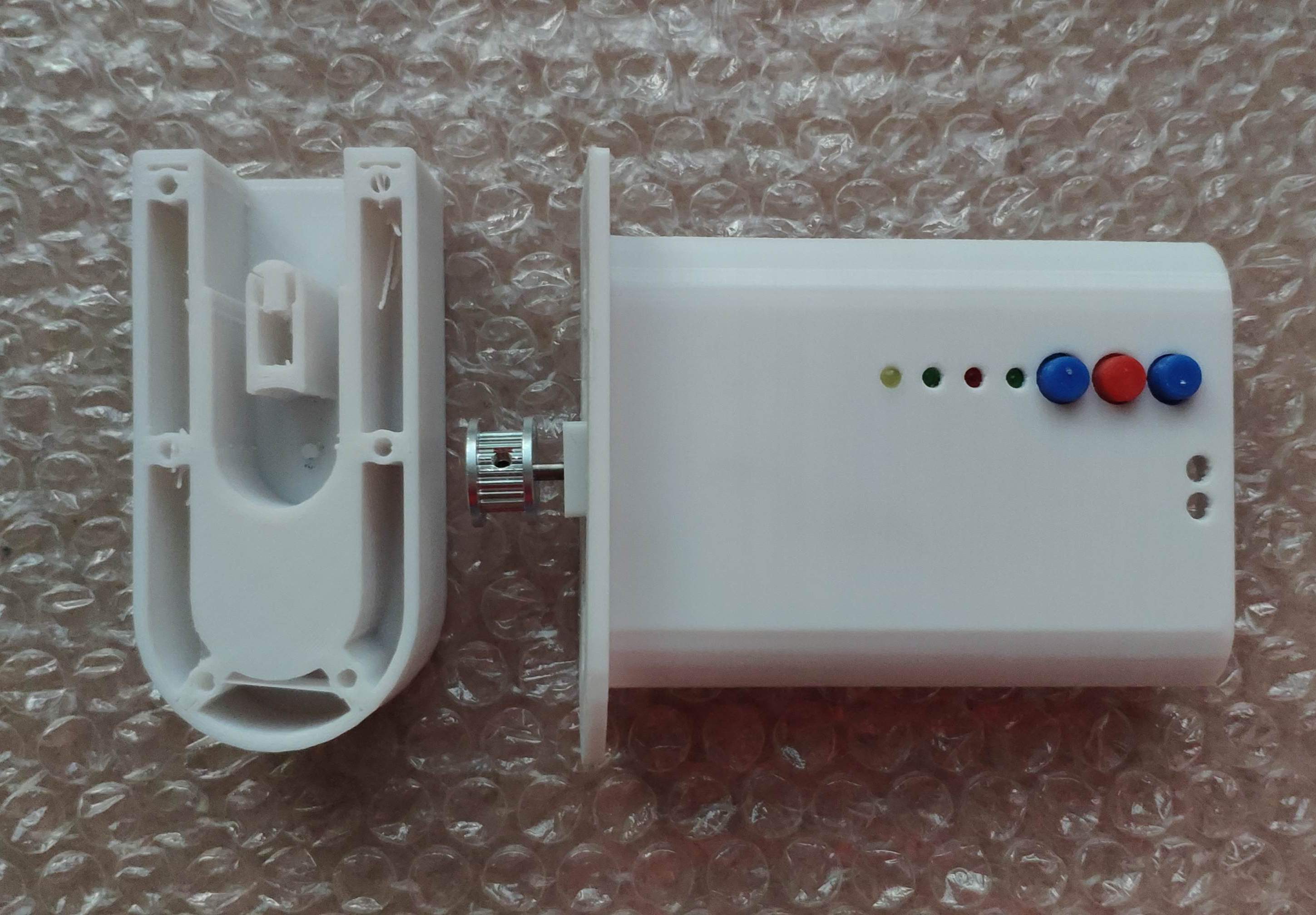

  The principle of this project is very simple. First, I modeled and printed two 2GT synchronous wheel transmission components and a synchronous belt closer. I used an N20 motor and a synchronous wheel to drive the synchronous belt to open and close the curtains... The following are the components produced:

  Below is the panel I customized. The on/off icon is relatively simple, but it is clear, intuitive and practical. The APP has timer switch and motor position calibration functions. It can set the middle open and full open modes to open the curtains, and the local PCB The panel buttons can be used to turn on/off/stop, and the indicator light shows the status...

Generally speaking, there are no big problems, they are all caused by small details and temporary negligence. The main ones are as follows:
        1. The CEN pin of the WB3S module is a reset pin without a button, so the subsequent secondary distribution network needs to be shorted to GND to enter the redistribution mode . During normal operation, the CEN pin should be pulled high or floating ( Due to negligence, I did not read the official manual carefully , and the official reference schematic diagram did not reflect it)
   2. I originally thought that I could use Bluetooth control when there was no network, but who knew it wouldn’t be possible, so I didn’t add a wireless control locally. I had to force it when there was no network!
  3. Later optimization direction, the motor was replaced with a stepper motor to reduce noise, the closer was changed to a pulley module to reduce friction, and local wireless control was added...
