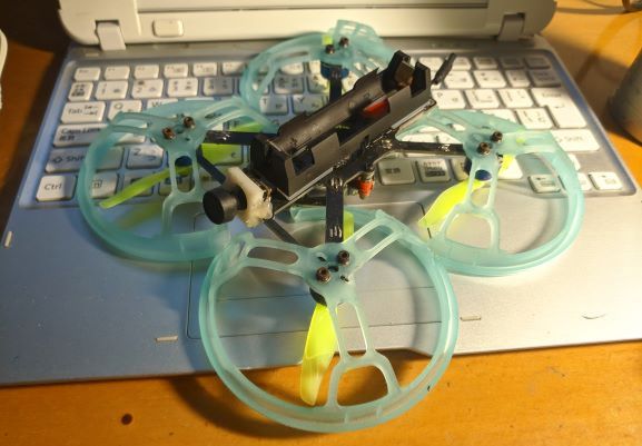

Currently using: zeus5, fli14+, Eagle Eye whoop card recording, ewrf500mw image transmission, Samsung 30Q, kingkong1104kv5500 (self-winding changed to kv11000), battery life is about 3 minutes, probably because the hoop is heavy and the motor kv is low, change to 3.85v The polymer battery should be more effective.
The power supply of the camera can be used for Eagle Eye 25mm card recording. It will not generate heat.
The image transmission power supply is seriously hot and there are ripples when pushing the throttle. It needs to be improved.
Since it cannot be installed, more than 2mm of the image transmission is sawed off. It is recommended to use Image transmission for sizes below 16mm
