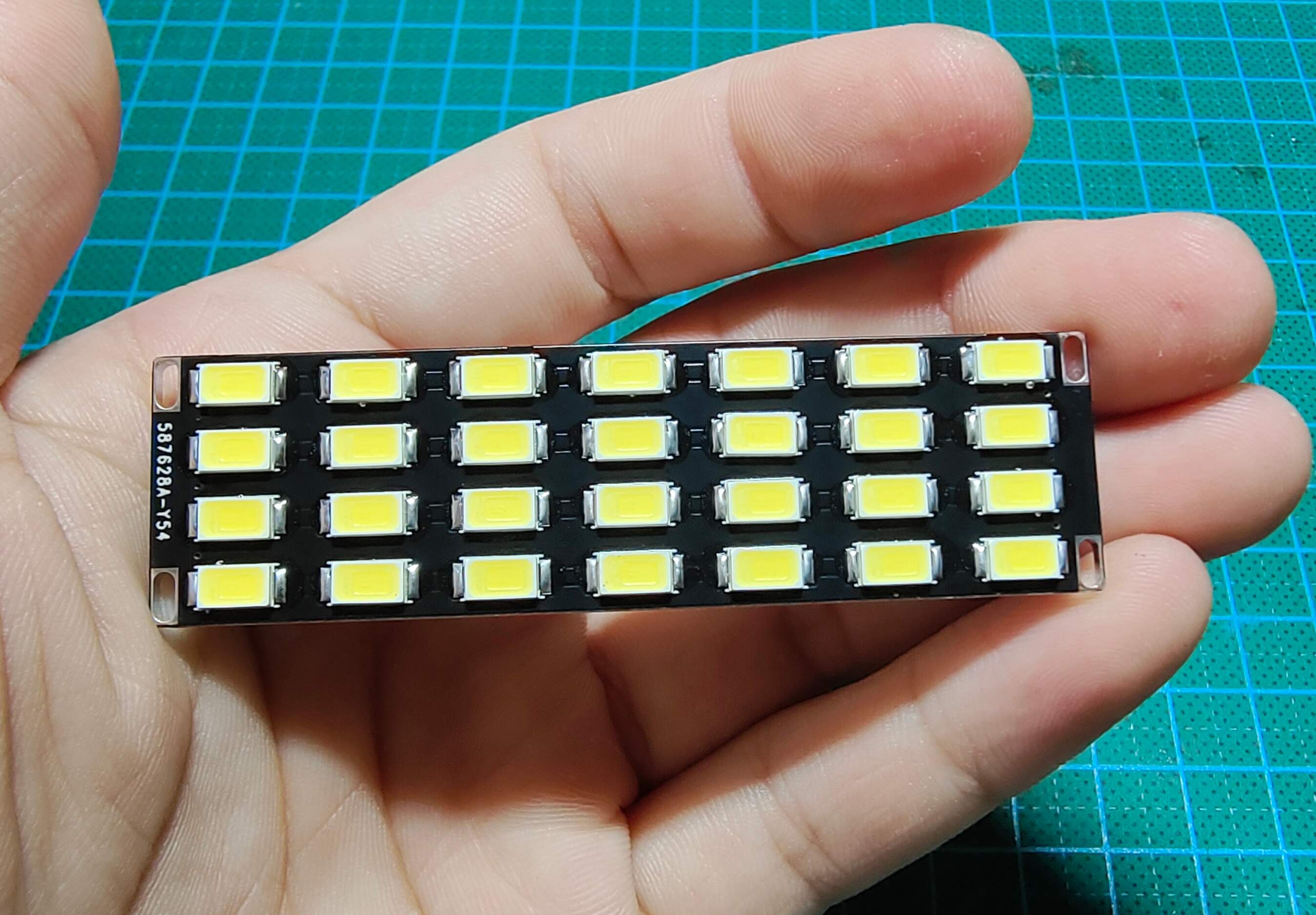

This project is the light panel of the 5358 power bank project
The driver chip is AP3032KTR-G1
28 pcs 5730 high brightness LED lamp beads
Input voltage 2.7~9V
This version will cause stroboscopic phenomenon when used with the power bank chip (the light board itself does not have stroboscopic, it is the stroboscopic caused by the key detection signal of the power bank chip)
Second generation flicker-free version https://oshwhub.com/wzw666/ap3032ktr-g1-ce-shi_copy
