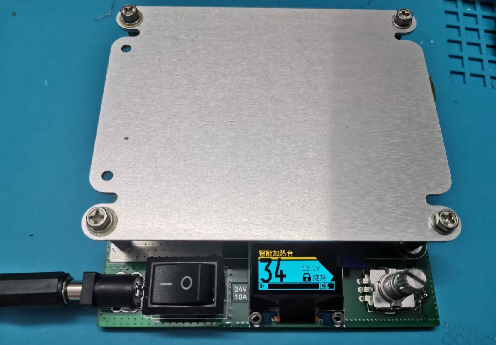

Modified from the ESP32 heating table - Jialichuang EDA open source hardware platform (oshwhub.com)  project,
change content:
     1. Only keep the heating plate and control board.
     2. PCB 10cm*10cm;
     3. The screen lights up when the power is turned on, without going through a switch; the boat-shaped switch is only used for the heating plate, and the heating plate power can be turned off manually if necessary;
     4. The size of the control panel has been changed, but the heating plate is still compatible;
     5. Removed some components and rearranged the wiring.
Instructions for use
  • The file system will be formatted when it is started for the first time, which will take some time.
  • Click on the main interface   to enter reflow mode
  • Double-click on the main interface   to enter power mode
  • Use long press in the main interface   to open the menu
  • Long press in the main menu   to return to the previous level
  • Adjustable PID parameters and Kalman filter parameters
