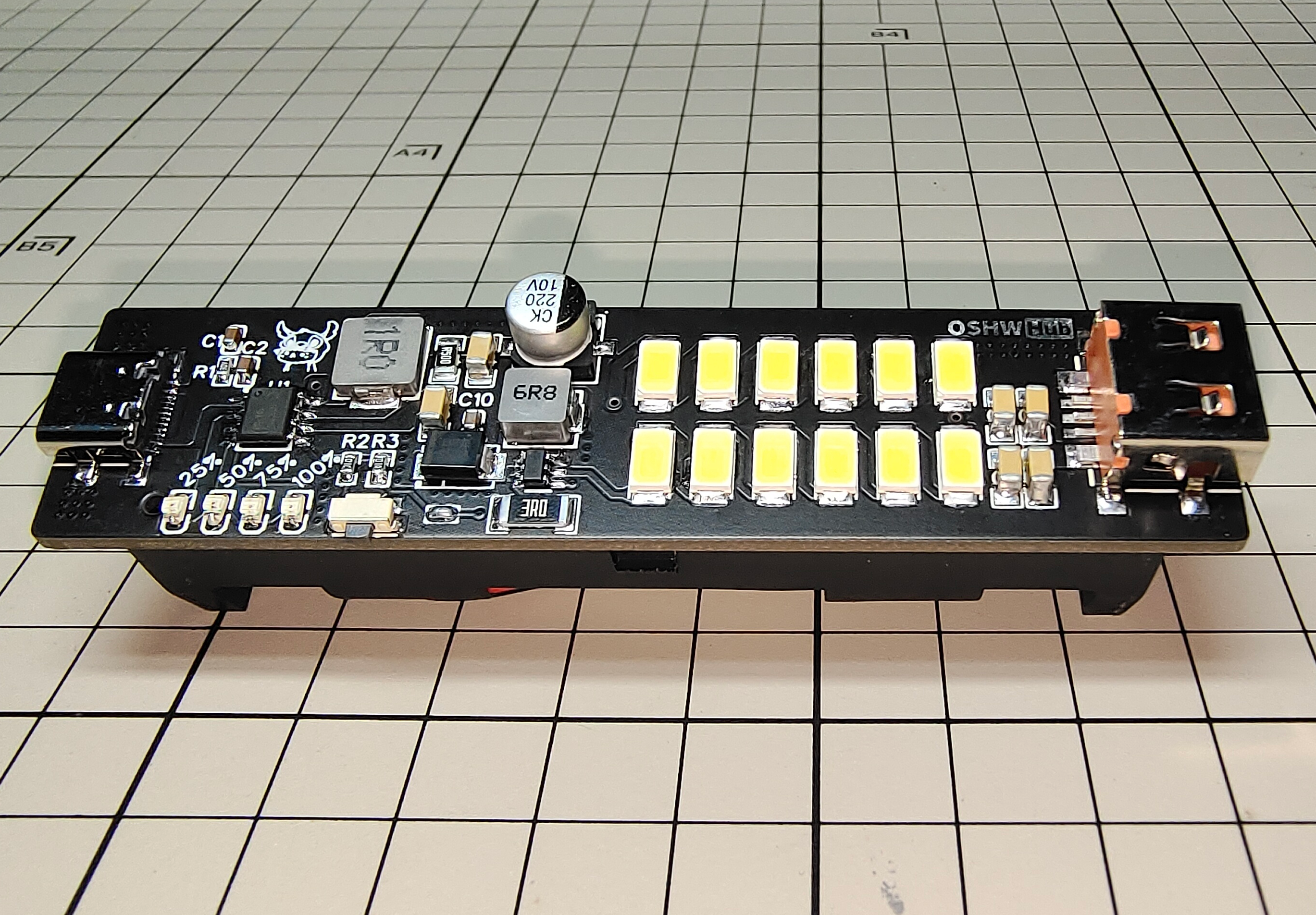

18650 battery charger based on IP5306 design.
Four-light power display with 12 high-brightness LED lighting lights.
It can be used as a 18650 battery charger or a power bank.
The problem of LED light flickering has been solved on September 14, 2021
Please purchase the LED driver chip AP3032KTR-G1 at Lichuang Mall. If you buy it on Taobao, you may buy fake products, which may cause the problem of being able to turn on the lights but not turn them off.

Synchronous switching charge and discharge
2.4A synchronous boost conversion, 2.1A synchronous switching charging
Boost efficiency up to 92%
Charging efficiency up to 91%
Built-in power path management, supports charging and discharging at the same time
Adaptive charging current adjustment, automatic Adaptable adapter
Supports 4.20/4.30/4.35/4.40V battery
Power display
Supports 4, 3, 2, 1 LED power display
Rich functions
Button power on
Built-in light driver
Automatically detects the insertion and removal of mobile phones
Low power Consumption
Intelligent identification of load, automatically enters standby
Standby power consumption is less than 100 µA
Built-in power MOS, single inductor realizes multiple protections for charge and discharge
, high reliability
Output overcurrent, overvoltage, short circuit protection
Input overvoltage, overcharge, Over-discharge, over-current discharge protection
Machine over-temperature protection
ESD 4KV, instant withstand voltage 12V
18650 battery box purchase link (click text)
TYPE-A interface purchase link (click text)
12 pcs 5730 high brightness LED lamp beads
