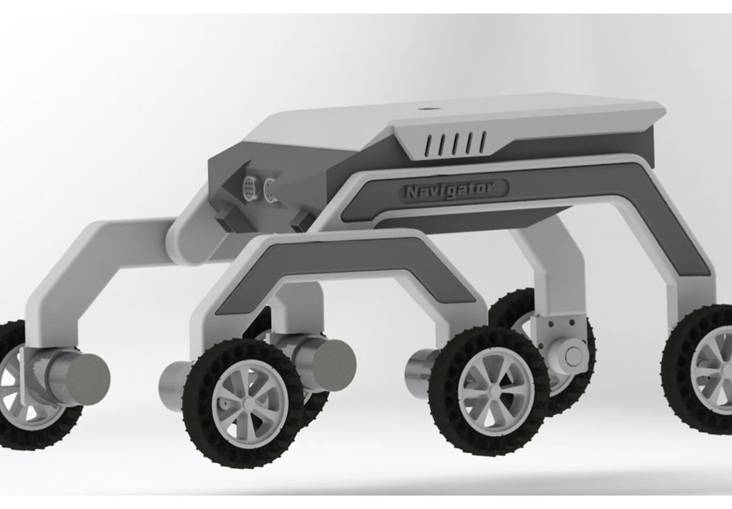

The design of the car is inspired by the Mars rover. The structure of the Mars rover is special. In order to ensure that it will not overturn or be blocked by obstacles when driving on the complex ground of Mars, its chassis adopts a structure called Rocker Bogie (rocker-bogie). The movable rocker adapts well to the unstructured ground, ensuring that there are always wheels that can touch the ground on uneven ground, unlike the traditional four-wheeled car chassis that may face the dilemma of the power wheel hanging in the air. Most importantly, this structure can climb stairs, which just meets my need for a car that can move freely in the building. Coincidentally, Jiali Chuang opened a car training camp, so this project came into being. :
### 1. Structural design
> *Modeling software is solidworks 2021*
> ![image.png]
> ![image.png] > **Parts list**:
> * GB/T 276-2013 61801 12 * 21 * 5 deep groove ball bearings * 6 //Place on the front frame and driven wheel shaft
> * M3x15 (at least) screws * 16 //Fix the motor and the rear frame
> * M3x5 screws * 10 //Connect the shaft and the wheel and the PCB and the main body
> * M3 nuts * 4 //Connect the main body and the rear frame
> * M3.5x8 screws * 2 //Connect the front frame and the rear frame
> * GB37520 reduction motor 12V 110RPM * 4 (In theory, the Rocker Bogie structure is best if each wheel has power to function best, but due to funding and subsequent upgrades, only four are currently used, two each in the front and rear.)
> * Several non-standard parts
> All non-standard parts including tires are made by 3D printers. Tires are made of TPU and the rest are made of PLA. Due to their large size, there will be requirements for the size of the printer, so they are made carefully. My printer is ender3 s1, with a size of 220 * 220 * 270. No need to separate parts, they can be printed by appropriate placement.
