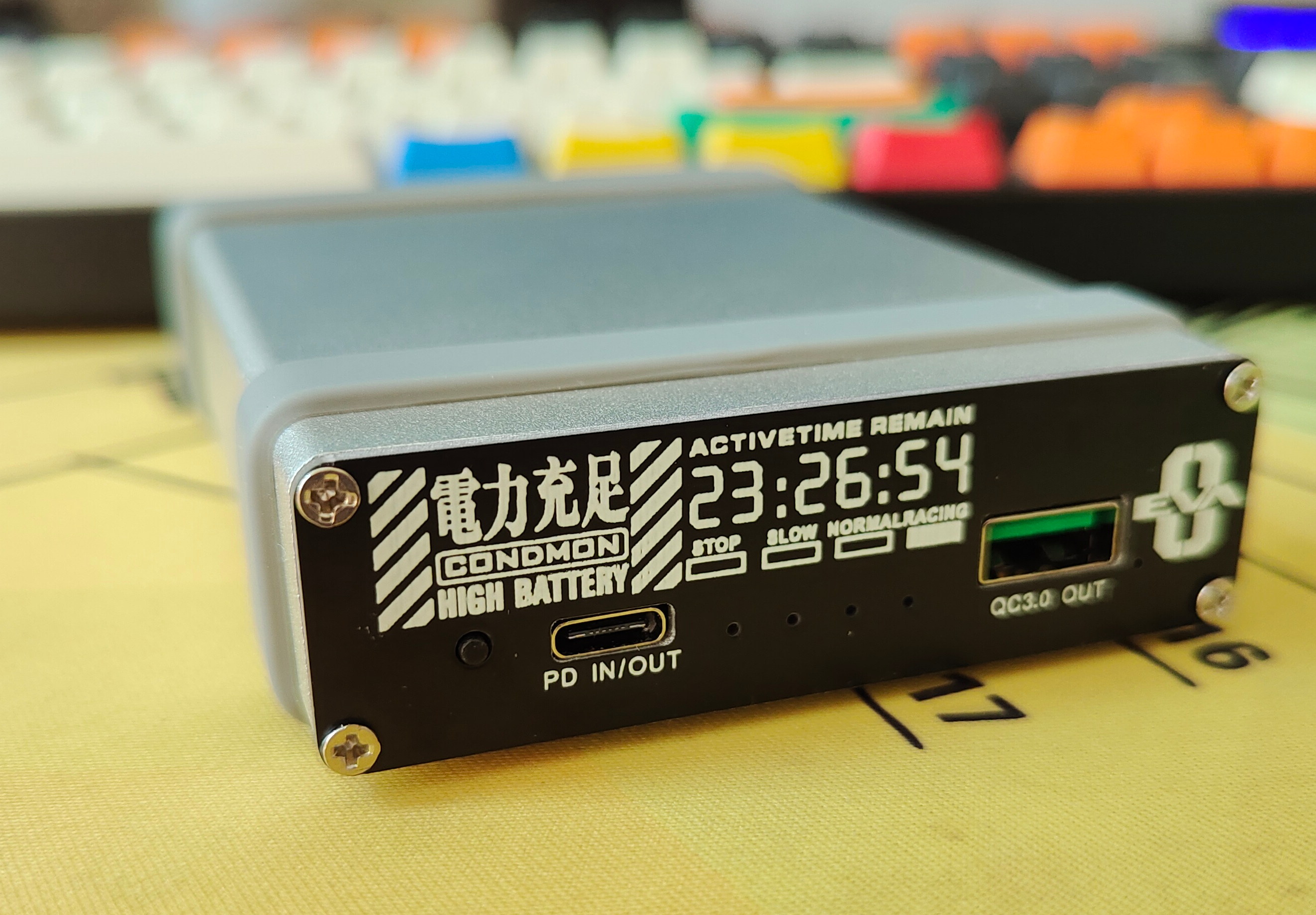

4-light power display with fast charging indicator light
1 TYPE-A port supports 22.5W maximum power output and integrates all 22.5W fast charging protocols
1 TYPE-C port supports 22.5W maximum power input and output, integrating all 22.5W fast charging protocols
Multiple protections, high reliability, input overvoltage and undervoltage protection, output overcurrent, overvoltage and short circuit protection, battery overcharge, overdischarge and overcurrent protection
The BOM is extremely simple, and a single inductor realizes the charging and discharging functions.
Designed with bright LED light panel (press and hold the button for 2 seconds to turn on/off)
Click here for the LED light board project link (the new version of the light board has been updated on September 15, 2021)
Aluminum alloy shell link click here

Four 18650 batteries are surrounded by EVA cushioning foam, which can just fit into the casing.
