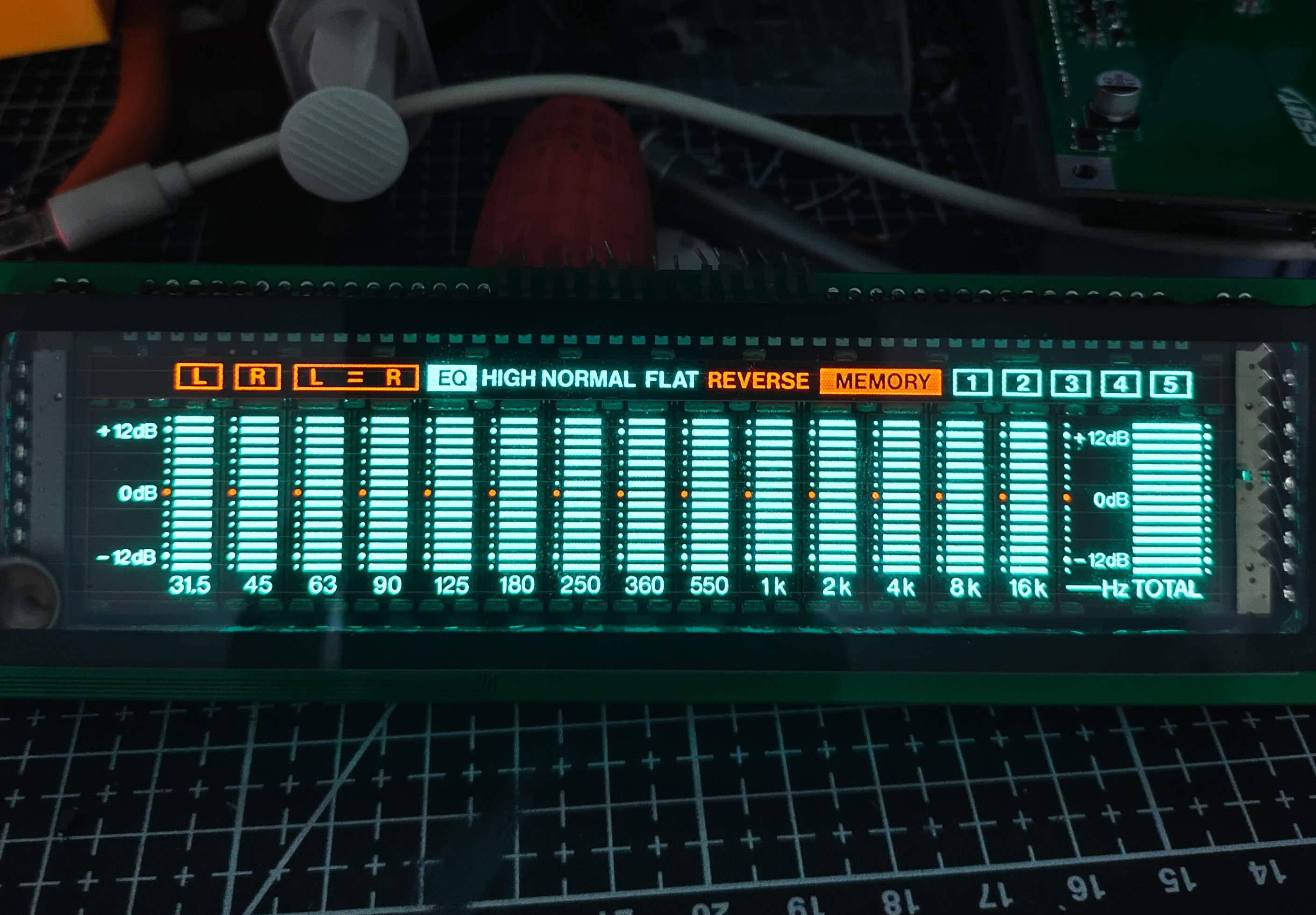

Show results
  • Three VFD40-1603 modules purchased from Xianyu
  • The following is the effect of FUTABA BG-900GK.
  • The following is the display effect of VFD40-1603.
